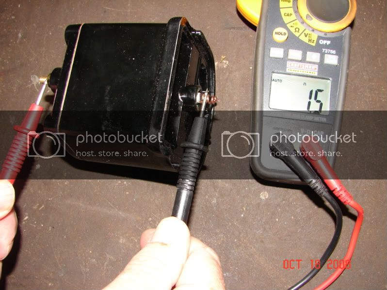

OK Rocky, kudos and mega-dittos on your 92 YO dad. You must be proud. Keeping the tractor in the family also is worthy of high praise. Now, all that being said by the replies on your electrical issues, some good, some not so good, buy no more new parts and further testing is required on your part. There is but one correct method to test the front mount electrical system on these old N's and have posted my old document I wrote in 2006 with B the help of Bruce (VA).
Too long to post so here it is in pdf
Tim Daley (MI)

OK, looks like they won't allow me to post my full 9N-12100 document in pdf so if you or anyone else wants a complete copy you'll have to email me. Here is a scan of the first page to give a taste. This is all the correct data and information on the 9N-12100 Front Mount Distributor and how tune-up, time, and test it, on your bench and off the tractor. I wrote this in 2006 and recently did a revision.
Tim Daley (MI)
