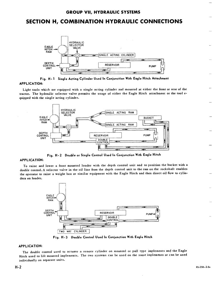

I have a VAC with an Eagle hitch. I want to add a remote hydraulic line. The only control valve I have been able to find so far online says it is adjustable to 100 psi. My shop manual says the Eagle hitc system operates at 800- 850 psi. Is that going to be an issue? Can someone recommend a source for single acting control valve the operates at 850 psi?

Northern Hydraulics or someone such as that can supply a cheap valve, usually they are set at a higher pressure but if you buy one with an adjustable relief you can set it at the desired pressure. Just know what you are doing as you can destroy things if the proper oil flows are not maintained from the auxillary valve you are adding back to the torque tube. If you have a good knowledgable hydraulic trained friend he could help you avoid some common mistakes. mEl

What mEl said and here's a link to more info on the Eagle hitch specs and combination diagrams: http://imageevent.com/skipjack/vamanuals/group7hydraulicsystems

Here is a simple way to hook up a one way cylinder at the lowest cost. Disconnect the line hooked to the three point cylinder and disconnect it from the valve that operates the three point. If the line is still the original steel line that came on the tractor there will be adapter fittings still screwed in the cylinder and the valve. Remove them and replace the one on the cylinder with the male half of a hydraulic coupling set. Put the female half of the set on a hydraulic hose leading from the valve and long enough to reach the cylinder. Connect them up and you have your three point again or let the three point down disconnect the quick release fitting and connect the female fitting to another cylinder and operate the cylinder with your three point lever. This is not as fancy as a diverter valve, but preforms the same function. Always be careful when disconnecting hydraulic lines to release all pressure.
