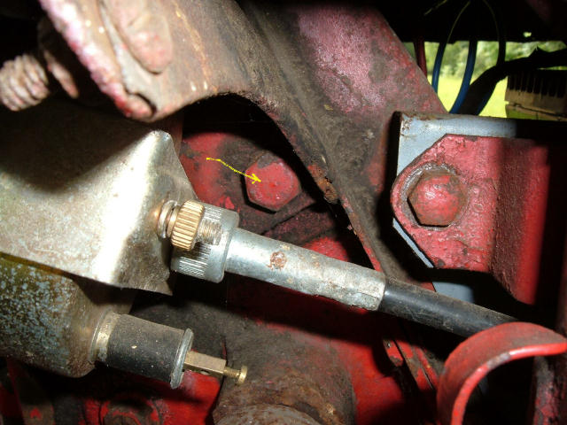

Serial# say 52 model 8n. Book say fill with 90w EP oil to top plug. Can t find plug, did some models not have a plug & what lube is in it. What am I missing, please help!!!!! Thanks WmN

Use J.Deere "cornhead grease". yellow, it stays in place, won't melt. You need to install a new zerk to push it in, use a Tractor Supply wheel bearing packing kit to get the zerk. Squirt it in until it starts to come up through the top of the steering column. After that you may need to wipe it up for a while on warm days, but it will eventually stop oozing out, and should be good for a few years. This link shows with the zerk installed http://www.chuckg.com/images/SteeringGrease5.jpg

also, when these were new, the oil was OK for lube, but with them this old, the oil will tend to leak out, hence why the cornhead grease works good.

I kelp looking at the picture and it didn't look like a grease zert was added. Then I saw you had an address to another page. If you just put that link in the "Optional Link URL:" just below the "Comments: " box the link will show up with you comment. Use "Link Title" below that to title it. You are right. Corn Head grease is the way to go.
Grease added the Steering Box

I took that bolt out and drilled thru the length of it, tapped it fore a grease fitting, works good. The 52 could have a screw on the steering column to put the 90 wt in also.

1952 model 8N Ford tractors have a fillister head screw (1/4X24?) in the steering column about 2" beneath the steering wheel.
You can fill here if you use 90W and fill from a squeeze bottle.
I usually remove the steering wheel and fill until I cover the top bearing to lube it, then replace the plug and wheel. It may slobber for awhile. Allow it to drain a bit from the screw hole if that bothers you.
If you use cornhead grease, you can remove the screw to act as an air bleed or simly fill until you see grease begin to come out beneath the steering wheel. It helps to remove the wheel.
