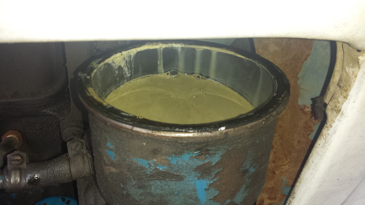

Finally got to replace all fluids in 1964 4000. Just popped the cap off the power steering, looks like that has to be replaced also. What is the best method for draining fluid? UTF corect?

You DO have the filter and filter retainer don't you? I've got the same setup, and what I did is use a turkey baster to suck the oil out. Had to do it about 3 or 4 times to get the water out, after moving steering wheel to left and right lock a few times. Yes, UTF. I know some guys take the filter out because water will freeze in it during cold weather, then the PS doesn't work.

I tried UTF in my 841S power steering and it did not work well at all. I now use ATF in it and have for decades and it has worked just fine. Looks like your missing the filter and if so get one before you use it much or you may find you have to buy a new pump and there not cheap. As for draining it take the lower hose off and it should drain out that way

No, I do not have filter and retainer. I will look up parts. Assume I can still get those parts?

Mine gets water in it like that anytime the tractor gets rained on. I just take the whole thing off and dump it, re-
fill, cycle it a few times, then take it off and dump it again. Takes about three times to get all the white oil out.
But you get really good at taking it off and on. Maybe a new gasket in the cover would help keep the water out.

Filter is available from CNH and others. Filter retainer NLS. You will need to find a donor pump for the retainer.
You will need to thoroughly flush the system several times to remove all of the contamination.
Use CNH Ambra or equivalent in the PS. Do not use ATF (Yes, I know that some do.).
