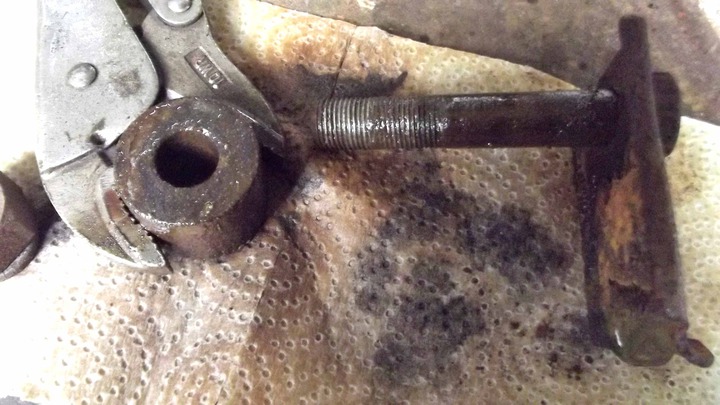

My bottles are empty but with flex bar, pipe wrench and pipe extension, I got the top bolt out COLD — couldn't even pound it out. This time I did soak with MP over two days.
Wasn't sure if the brace angles would prohibit this move, but i moved the front braces to the outside so the stepped pins now work on the inside.
The original spacer will go back between the rear braces and I just need two more spacers one on each side of that.
It could be that whenever new ball ends were put onto my lower link arms, that the arms got a bit shortened, so if I ever have to replace the ends I'll make the arms a little longer.

Pins to the inside arms to the out side big arse space in the middle someone made modifications to use it on a cat 0 set up...
I have heat and a air hammer that will break your hand... Not much time for a hope and a prayer soak'em treatment...
I am still not sold on it but keep the faith...

PostPosted: Thu May 18, 2017 7:05 pm    Post subject: Re: Cultivator Modification Reply to specific post Reply with quote
Hobo,
Actually you're dead right!
Soaking it didn't do diddly squat.Smile
It wasn't until I got it to move a sixteenth in both directions, with 4' pipe on the flex bar, that it even started to let the juice in. But after a quarter inch movement in two directions the black then brown poured off it as I worked it. What you see there is only after I laid it down in the shop on a white towel and dribbled the stuff on it.
Unshakable faith,
Terry Very Happy

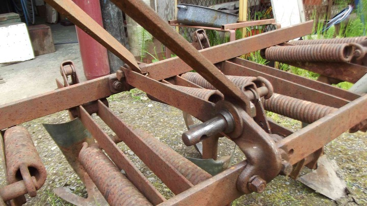

PostPosted: Sat May 20, 2017 12:42 am    Post subject: Re: Cultivator Modification Reply to specific post Reply with quote
I when out and made a few pictures of my old cultivator frame. Yours may be different because it was stronger build as it was a field cultivator rather than a row cultivator.
here goes a few pictures.

PostPosted: Sat May 20, 2017 7:42 am    Post subject: Re: Cultivator Modification Reply to specific post Reply with quote
I finally see what you are talking about, the lower lift pins are mounted different on the field cultivator
there is a big difference in the hitch assembly of the Ferguson (field cultivator or some call them tillers)what you have
and the regular cultivators what I have
also note the picture of the heavy duty Ferguson field cultivator or tiller, I always assumed the one with the heavy support bar across the hitch area was the 9 shank model. However it could have been modified by a welding shop but the frame looks the same, just the heavy pipe support.

PostPosted: Sat May 20, 2017 8:45 am    Post subject: Re: Cultivator Modification Reply to specific post Reply with quote
Max,
Are these photos all of your own equipment?
The Cultivator photo is exactly the same as mine right down to the "Chisel Plow Sweeps" on the front row and the "Beet Sweeps" (winged ones) on the rear. So I guess that was factory and not just a user option. Very interesting!!
I took one of my pin mounts off and reversed it so that the pins are out front of the frame, just to see. If I ground off just 1/8" from the bottom of the mount hole area, then the bracket will sit inside the angle iron — with pins out front. We shall see.
I'll probably just put it back together and see if I can live with not being able to lift the Cultivator too high.

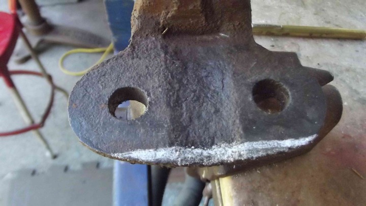

PostPosted: Sat May 20, 2017 11:01 am    Post subject: Re: Cultivator Modification Reply to specific post Reply with quote
Plan B
I turned the pin bracket around to see how things would shape up. It would move the Cultivator far from my fat tires.
In the photo I marked off how much of the lower part of the bracket would have to be cut off in order to mount them inside; the only other thing is that the A Frame tips back because of the length of the back braces.
Maybe the top link adjustment or a fixed top link (I have lots of bars) would make up for that tilt back, but I could also add length to the back braces if necessary.
But the pin position looks great this way.
