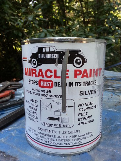

I have been using this for over 25 years on under body
and frames. It comes in black, white, sliver and clear. It
will stop rust and it gets harder than the pits of hell. I
have not used it on the outside body sheet metal but I guess a
person could. The dry time varies with the temp. and
humidity. If it will be exposed to sun light you will need to top
coat while it is still tacky, it dries so hard you have a hard
time scuffing it up. Use a good respirator and rubber gloves, If
it dries on your skin you will wear it off, worse than PVC glue.
I used it on the under carriage of my motorhome 6 years ago and
It is still good.
