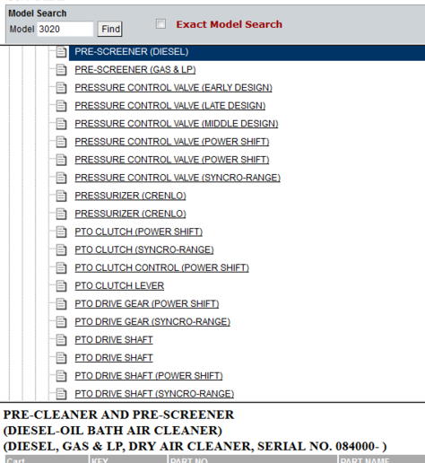

PostPosted: Fri Aug 11, 2017 7:30 pm    Post subject: Re: 3010 h00d 0r 3020 hood Reply to specific post Reply with quote
Early 3020s had the air cleaner through the hood. Late ones did not. I'm not sure, but the muffler opening might be different for gas/diesel

PostPosted: Sat Aug 12, 2017 2:42 am    Post subject: Re: 3010 h00d 0r 3020 hood Reply to specific post Reply with quote
JDIH wrote:
(quoted from post at 22:30:06 08/11/17) Early 3020s had the air cleaner through the hood. Late ones did not. I'm not sure, but the muffler opening might be different for gas/diesel
Hoods for diesel & gasoline engines are the same. Hoods for 3010 & 3020 up to sn 123,000 will interchange. IIRC pre-cleaner for air intake was an option for both 3010 & 3020's

PostPosted: Sat Aug 12, 2017 4:23 am    Post subject: Re: 3010 h00d 0r 3020 hood Reply to specific post Reply with quote
This one does not have air stack hole.

PostPosted: Sat Aug 12, 2017 9:31 am    Post subject: Re: 3010 h00d 0r 3020 hood Reply to specific post Reply with quote
The late[69/72 3020 hood would have an oval hole for muffler
