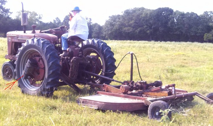

Last week I used bungie cords to strap my welder tank to the wheel of my tractor. Put a quart of acetone and about 2 cups of bolts, nuts, screws in it & mowed for 2 hours. Washed with water, blow dried with air, filled it with diesel to void all aor pockets. Will dump that into a clean white bucket & examine. If nice, will rinse with non-ethanol gasoline (not the e- crap that caused the problem) & fill & see if I can keep it full from now on.

PostPosted: Fri Aug 11, 2017 12:04 pm    Post subject: Re: Fuel tank cleaning Reply to specific post Reply with quote
My "slosher" or "cement mixer" substitute.

Most people prefer to put a lot more work into it than this, but I bought a diesel tractor some fifteen years ago that gave me problems due to all the crud sloshing around in the tank. I siphoned the stuff out, no more problems. Too easy I guess.
I don't mind the 'slam', I can take it, but you need to come over an "siphon" the stuff out of this tank. The best vacuum in the world would not clean up this tank. It needed a major beating!

[quote="showcrop"](quoted from post at 08:25:19 08/13/17)
JMOR wrote:
(quoted from post at 19:43:37 08/12/17)
showcrop wrote:
(quoted from post at 21:12:28 08/12/17)
JMOR, honestly not meant as a slam. Just stop and think for a moment about how frequently this topic comes up, and I have posted about what worked very well for me at least 25 times but never any interest. Some tanks come off fairly easily but the tanks of the Fords like I have are a major project. Yes there are different degrees.
OK. This was a lot worse than just slime....it was accompanied with dried/hardened slime & rust. Abrasion was about the only way I see to clean that up.
