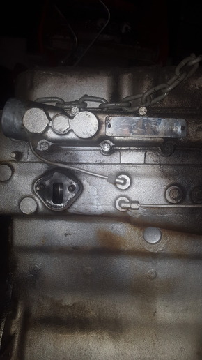

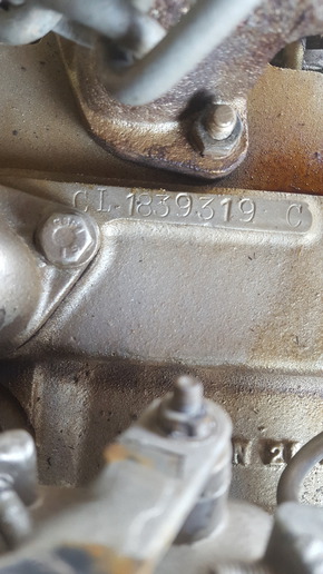

I have a 78 or 79 MF 245, pulled the engine and I need to try to figure out some identification. First thing I noticed was the oil pan had a round cover on the bottom, with a screen that was cut off. The screen wouldn't have fit because the oil pick up tube has one on it already. Then I noticed it has a 2 piece rear main housing, which I thought it should be a 1 piece seal. The only numbers I think would be a serial number are stamped into the block above the injector pump on LH side and these read " CL 1839319 C "
I don't know if that is a complete serial number or what. I suspect this engine was swapped in at some point but not sure. I will need to order some parts for this so I need to know what I have.

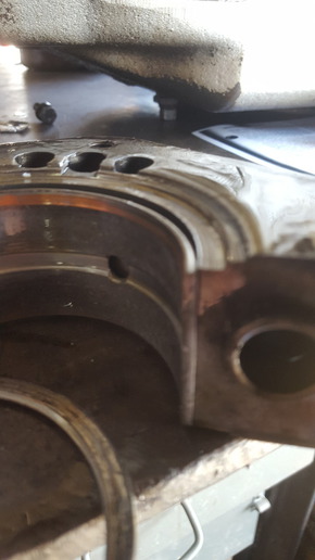

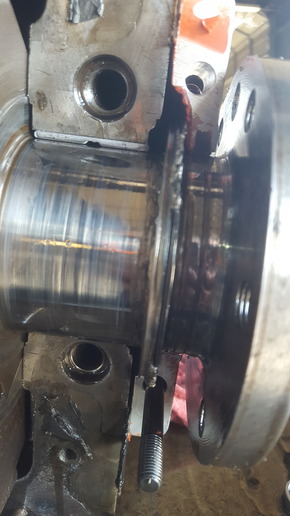

Well, Im not sure what I need now, this engine is very clean, everything looks recent BUT... The thrust washers in the front were gone, chewed up. The rear washers were wadded up. Looks like the crank has been repaired at one time because of that but the block and main cap have a nice groove.
I'm not sure these pieces are salvageable at this point, crank, block and main cap all have wear. I will load some pics if I get my phone camera in there close enough.

A few of those pictures show the crank surface where the thrust bearing would sit, it looks like 3 pieces there and some spot welds holding them on. Was this repaired or an attempt made at some time? You should be able to see the groove in the block and main cap, the crank was also eating into main bearing surface too

The serial number should be stamped on the right side of the engine somewhere above the starter. Looks like someone put a lip seal crankshaft into a 2 piece seal block, and "rigged" it to work.

Well, it didn't work. I'm not sure what I need to do at this point. T I did not tear this apart for any symptom related to what I found here, it was an oil pressure issue. I noticed this when I took the little round oil pan cover off and found metal thrust washer debris.
I don't know or don't think this block will be salvageable. The damage to the block and main cap is what bothers me. I was fairly prepared for a rebuild with the possibility of crank.
I looked for a serial number on the RH side, pretty sure there was nothing over there. I read that it was on block just in front of the lift pump, and nothing was there.
Forgot pic of main cap, showing grooves in cap and bearing from crank

Someone put a 3.152 from a early MF 35 tractor, they had the round cover on the bottom of the oil pan. I wouldn't use that block, or crank. On the exhaust side of the head is it flat, or does it have block off plates. Also are the injectors in at a slight angle, or are they straight up, and down.

There is a flat on the exhaust side, that's where the numbers are stamped. The injectors are at a slight angle and the intake is labeled ad3.152.
On the serial number, a local shop I talked to said he's encountered numbers like mine and believes the engine probably came out of a welder or other stationary engine type equipment.
