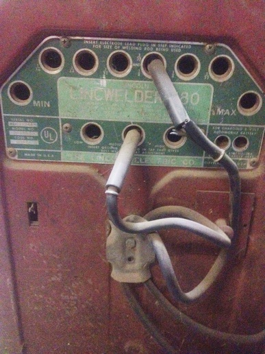

Yo Forum Chums!
Picked up an OLD Lincoln Stick Welder....you change the voltage by turning a crank...I bet it is even older than Royse!!....I am sure it is older than Bruce!!....Here is the question...no
manual...what amp breaker are y'all using with your stick welders?...gonna be using 6 or 8 gauge wire in a short run to the welder...Many Thanks!

Nice to know you're back safely! Smile
Lincoln has manuals available for free download here.
I have an old Lincoln tombstone that you change the voltage by
unplugging the cables and plugging them back into a different hole.
Tag says it's a 1936. Has a 6V battery charger built in too.
Yes, those handles are knurled metal.
Manual suggests turning it off before unplugging them. Wink
I also have a newer, AC only tombstone with a fancy switch.
Both of them are wired with 8 GA wire. I'd have to check for sure,
but I think they are on 40 amp breakers. I can check tomorrow,
but I'm fairly certain they are not more than that or I would
have used larger wire.

i've got a semi-modern lincoln ac/dc 225/125 on ~ 30" of 10 gauge and a 50 amp breaker. breaker hasn't tripped, but it's never been dialed up anywhere near those numbers.

I must be older then dirt as I still have the Lincoln welder with turn dial for amps and I have the booklet which states "The power required for the welder are listed on the specification label plate for the welder". I had to replace the 40 amp breaker with 60 amp breaker to keep it from tripping out. Buy wire size for 60 amp

I have 10/2 with ground romex running about 50 ft with 50 amp breakers on each leg. House also runs off same breakers, YA pushing my luck. Goes to Lincoln 180 buzz box. haven't had any problem in almost 30 years

I have an old Fortney plug-n-play 180 amp. stick welder that has aluminum windings. When I started using it I melted a couple of leads off the plug-in sockets on the welder due to loose and dirty connections of those female plugs . During the course of the welders life the aluminum leads to the plug-ins loosened up a little from many years of use. Add a little corrosion to those loose connections and you start melting the leads off. After I took it apart, I cleaned the connections and reassembled them, using dielectric grease on all the connections to get it working again. After a little more use the capacitor burned up. I ended up using a large electric motor capacitor to get it working again. So, if anyone buys an old aluminum wound welder they should clean and tighten all connections before the welder is put to use.

Mine are on 40 amp breakers Ed. I've never tripped either one,
but I don't usually crank mine way up to weld or cut, either.
