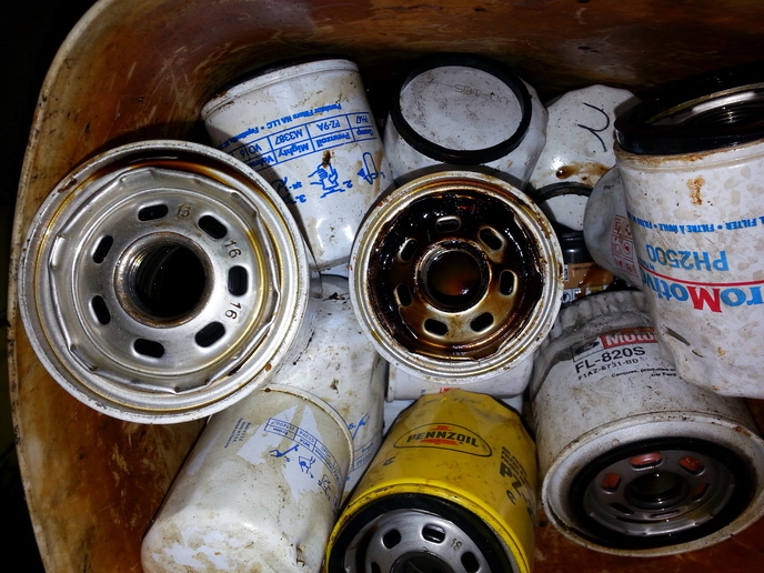

PostPosted: Tue Nov 14, 2017 3:42 pm    Post subject: Re: Dirty motor oil Reply to specific post Reply with quote
Looking at the filter base is a good indicator of what the inside of the engine looks like are if you have a issue going on. The filter base should be as clean as the day you put it on unless you are one of those that believe in extended oil changes Sad...
Most of these filters have bout 3/5K the dirty one in the middle 3K he was losing a qt of coolant into the crankcase between changes causing sludge issues.
