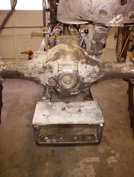

A friend of mine has a WC 148606 Which I figure is a 1946 model. What's odd about it is in place of a transmission disconnect a lever that's sticks almost straight up and has 3 positions with a gearbox on the bottom side, I think this is a Sherman overdrive, and the rearend has a plug in the very rear with the fill plug over to the left side. I have never seen one quite like this. The plug is about 3 inches in diameter. Have no pictures wouldn't be able to post them. Wonder if anybody has seen one like this

does sound like a under/overdrive, does the rearend look like this?

Yes it does

It must likely is a Sherman two speed. It could either be a step up or a step down transmission. They made both. From the way it sounds its a later one. The first ones had a detent ball to on the lever but as they got used the springs got weak letting it pop out. The later ones had what I call a crowd foot pattern so it would stay in place. I own an example of both. As for the plug I have seen it on a few WC's. I'm not sure if you are familiar with 85-140 weight oil what the recommended for the rear end. It ain't to easy getting the slow running stuff in the fill. Lot of folks put that on there so it was easier to fill the rear end fluid.

Sorry about that. I was mistaking about the rear end. I thought they put and extra piece on to fill it. That is a knock out I believe to get the bearings. And the small plug is what I was talking about is the fill plug
