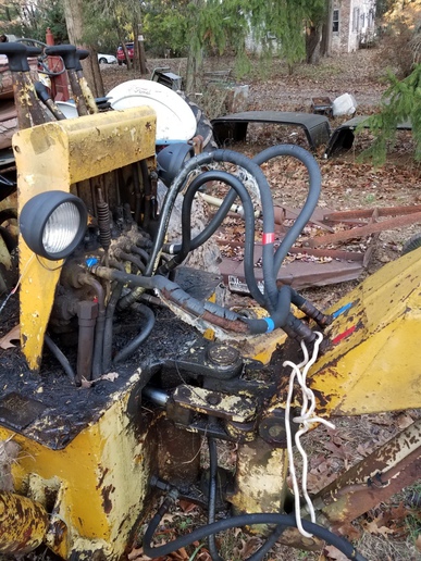

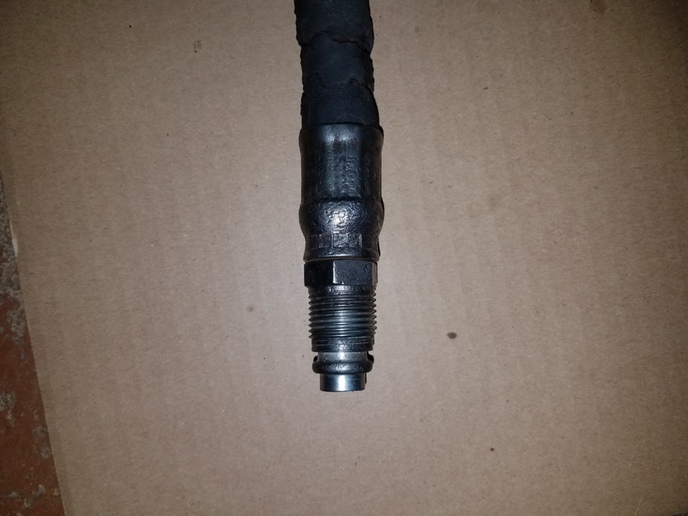

I have an old Ford Industrial Model 1821 backhoe that I need new hoses and hydraulic fittings for. I have tried the local hydraulic shops, but they don't have such old fittings like the ones that I need. Can you recommend where I might find either the entire hose assemblies or just the fittings, which my local hydraulic shop can install here in New Jersey?
Thank you,
Ivan

Well you have to improvise and there are multiple methods. The
fittings are called O-Ring Port by Weatherhead and Discount Hydraulic
Hose, commonly known as bump tube. They were used mostly for
automotive air conditioning, power steering, various truck usage, and
industrial usage. The size Ford used is #10, 7/8"-14 Threads per
Inch. However if you can find current 7/8 crimp fittings they are
usually 18 TPI and typically aluminum not steel (for air
conditioning). Discount Hydraulic Hose has adapters to JIC, see link.
I've used and seen various methods including adapters, standard
fittings brazed to the tubing part of the old fitting, new crush
collars on the old fittings, and new #10 crimp-on ORB-SAE fittings.
#10 O-Ring Boss fittings are 7/8"-14 straight thread like the
originals so they fit, but I use thread tape and sealant plus the
outer O-ring to make the seal instead of the original inner O-ring
seal method. If interested I can post pictures.

I got this backhoe used over twenty years ago and then it was in bad shape. All the hoses were makeshift rigged in all kinds of ways. These two hoses that burst are from the bottom of the main boom to the control housing. One hose has the straight fittings on both ends, and the other has the angle fitting on one end and a straight fitting on the other. They are both about 3 feet long or so.
I haven't used the tractor for over five years, when the hose on the top of the boom connecting to the other boom, burst. I am very mechanically inclined, but there was no way I could figure how to reach into the boom to get access to the fittings, which by the way, were so badly rusted away that there weren't even sides on the fitting for a wrench. I still don't know how to improvise a home made solution to maybe route a line alongside the lower boom. Anyway, that's why I stopped using it on the farm. I tried starting it last year, but no gas went to the carburetor and it was winter and the fuel shutoff was leaking profusely, so I gave up. I recently decided to work on the beast and took the Marvel Schiebler carburetor off and rebuilt it.The wild rosebushes took over and I had to clear the whole area to work on it. The inside was green with corrosion. I carefully cleaned the float and hinge assembly, which was stuck in the shut position. I cleaned it all up and it works fine. I also, with great access difficulty, replaced the gas tank shutoff. Then, since the 12 volt generator I had rebuilt several times years ago, wasn't working I decided to do an alternator conversion. While I was at it, I also wired taillights/flasher lights on the fenders for when I use it to clear the 600' driveway of snow at the highway entrance for traffic safety. I figured that I would just not use the backhoe part, until when I just started it to move it, the two lower hoses burst, and I am forced to repair them. So that's where I am now. Smile

Are you saying that if I use the adapter in the link, (41157-10-10 | 5/8" JIC Male x 7/8-14 Ford O-Ring Port Male) , that I could buy four of these and then get readily locally available hoses with fittings to mate with the 5/8" JIC male end? Does this sound like a good idea? Hydraulics repair is new to me, and this would be a new experience, so please excuse my ignorance. Smile

Yes, the adapters allow the use of standard JIC hoses. However the
adapters add length so you have to be careful about causing mechanical
interference, especially with the bottom boom hoses. Full swing might
mash the hoses (that's why the original fittings are angled). The
other bad thing is that the adapters are kind of expensive, about $15
each.

Just to be sure, the Ford end would definitely fit the tractor / boom? What would I ask my hose shop to mate with the other end by name? How much longer, in your estimation, would the adapter make the fitting connection be? There will be no clearance problems to the boom that I can foresee, but I have to check tomorrow in the daylight about where the angled fitting connects to the tractor controls. I don't know if you can make it out in the attached pictures. Specifically, the ones marked with the red tape is the angled fitting. It was hard to get a closer picture of the angled fitting. $15 for each adapter is quite affordable, considering the $350 alternative. I don't know how much they would typically charge to make two 3' hoses with the more commonly available JIC mating fittings. Would they be 1/2" or 5/8" hoses?

The adapters should work at those locations. JIC 10 female swivels
are available for 1/2" hose. If you don't want to spend a lot on the
hoses Surplus Center has premade lengths with JIC 10 female swivels
and 1/2" hose, 36" for about $16.95 2016 catalog price. The angled
fittings and clearance problems I was talking about are down below as
shown in my picture, not the ones in your picture.

Just wanted to get back to you as soon as I finished the job. Blake from www.discounthydraulichoses.com set me up with the correct JIC fittings, angle and straight swivel, and custom made hoses, as well as the adapters that you recommended, at a reasonable price. I had to buy a few more wrenches for the job, even though I have quite a few large open end wrenches that I collected over the years for other heavy equipment jobs. The entire job went very well, with no leaks. I first thoroughly cleaned the area around the fittings and then used a 3/4" steel brush on my drill to clean the inside threads and the O ring seat. I put a few drops of oil on the adapters and hand tightened them in, and then tightened them securely. I followed the recommendations for torqueing the dash line #10 JIC fittings. Perfection!
My next job, which is daunting, is to replace the two hoses at the top of the boom. The fittings are recessed in the boom, so I ordered some crowfoot wrenches. Thing is, it looks like a mish-mash of different connector combinations makeshift by the previous owner(s). One side is different from the other, plus the hydraulic tubing line fitting is no longer attached to the boom inner frame, so I will have to figure a way to hold it from twisting the tube when I try to unloosen the stubborn hose fitting. They have been soaking in PB Blaster for weeks. I will let you know when I make some progress.
