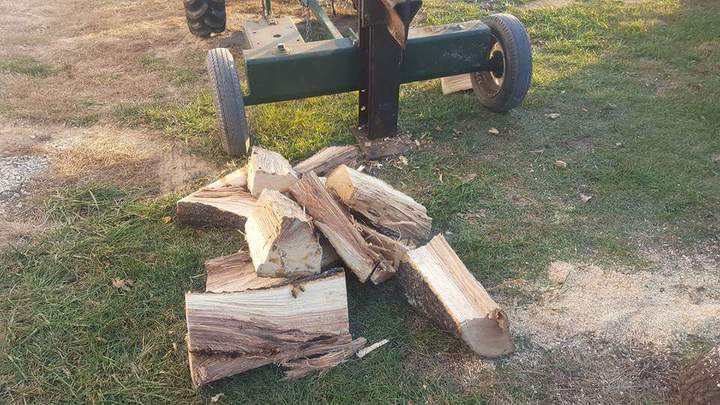

(quoted from post at 18:18:56 12/02/17) This would usually get left in the woods.
No problem for the splitter
lovely piece. is that elm?
red oak

Kevin, is that a kit that you can add or did you fab that pump attachment and put all the pieces together?
Back to top
View user's profile
kev518n
Regular
Joined: 24 Feb 2016
Posts: 191
Location: bendavis mo
Report to Moderator
PostPosted: Sat Dec 02, 2017 7:30 pm    Post subject: Re: Splitting wood with 8n Reply to specific post Reply with quote
allenlane wrote:
(quoted from post at 18:52:19 12/02/17) Kevin, is that a kit that you can add or did you fab that pump attachment and put all the pieces together?
I fabed the bracket and put all the parts together.

kev518n wrote:
(quoted from post at 07:27:51 12/02/17)
Flatheadpete wrote:
(quoted from post at 06:48:07 12/02/17) That's something I'd like to do with mine. But I have a good friend who has a splitter we built out of a scrap Wheel Horse garden tractor...hood and all! It works way too efficiently to justify the expense to make my 9n do it.
I'm confused, how is the pump driven ? I think I see a chain drive on the front of the pump, but what is it attached to ?

SteveB(OH) wrote:
(quoted from post at 11:31:49 12/04/17)
Shaft driven off the crankshaft. The roller chain is a flexible shaft coupler. A more interesting question is where is the hydraulic reservoir and what else is that pump doing Wink

TheOldHokie wrote:
(quoted from post at 15:20:09 12/04/17)
TOH
the reservoir is tractor belly. pump runs the remote and my front end loader. along with live hydraulics
