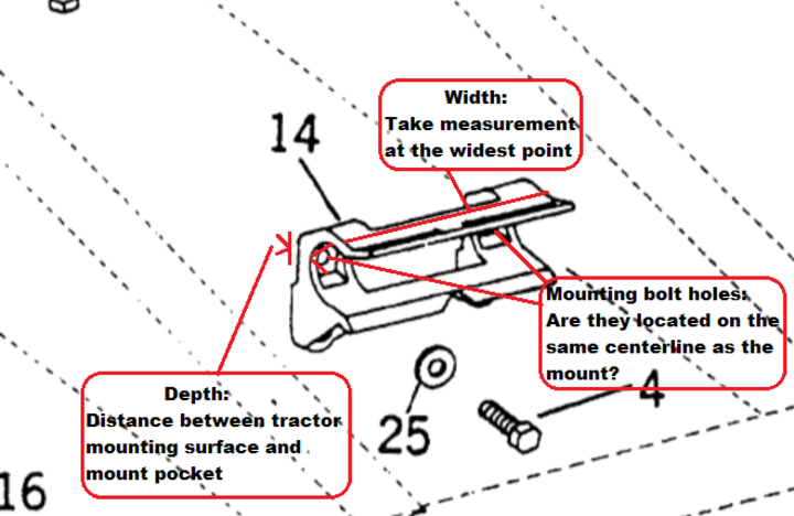

Hello,

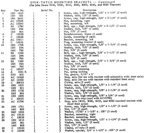

I'm the market for the seemingly elusive front mounting bracket for a John Deere 48 loader.
Item # 27, P/N C19239 as per the diag. & details below.
If anybody has one they'd be willing to part with or perhaps even share some detailed pictures of one with some measurements so I could fab. my own I'd be very grateful.
TIA,
Glen

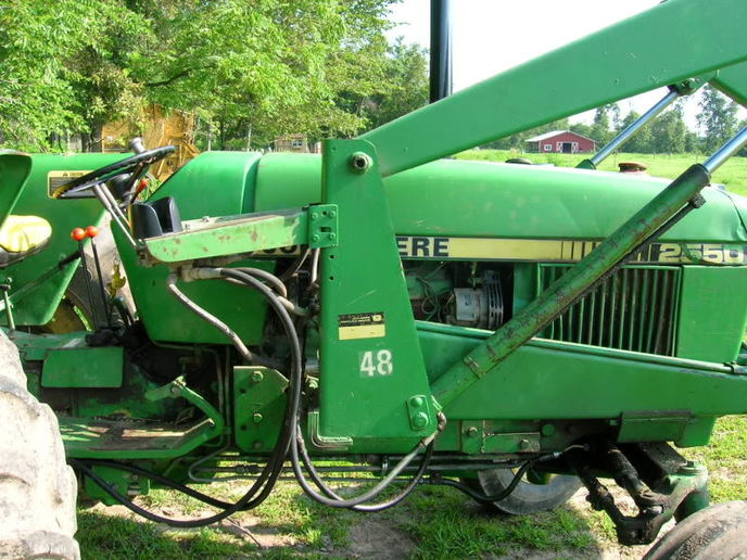

Had one on my last tractor. Should be able to make one if you mount the loader on the tractor and support the front. A proper size piece of C channel with a backing plate should be enough. On mine, only the bottom set of holes were bolted to the tractor. It was on a 2550.

Some pics - hope they help.

The main measurements I'm looking for are:
Width - The maximum width of the mount pocket.
Depth - The distance between the bottom of the mount pocket & the bracket to tractor mounting surface.
Mounting bolt holes - Are they centered with the mount pocket?

The tractor was traded in but still is on the dealer's lot. I will try to get these measurements for you. Also, maybe some closeup pics.
On my tractor, there were 4 holes on the front end bolster. The bracket has 4 holes also, but was mounted such that the bottom bracket holes were bolted to the top bolster holes. The upper part of the bracket was above the bolster in front of the grill (you can see that in the first pic). The second pic shows that the support arms for the loader were parallel with the ground on the bottom line. Having them any lower would have caused the front end to hit the travel stops too much.

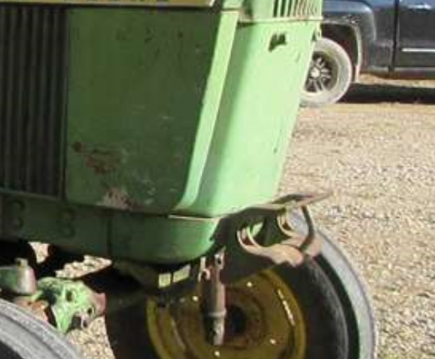

I managed to find a picture on the 'net of a 4020 with a 48 front bracket installed & I think it answers my question of whether the mounting holes are centered with the mount pocket.
So, it looks like I only need the width & depth measurements.

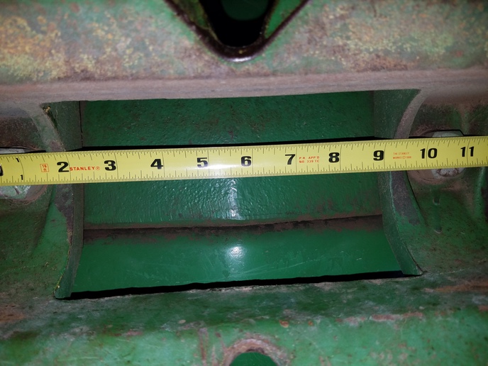

I have one on a 4010 I can take a picture
of. It's to dark tonight but I'll get one
tomorrow.

PostPosted: Tue Dec 05, 2017 8:35 am    Post subject: Re: John Deere 48 Loader - Front Mounting Bracket Reply to specific post Reply with quote
The 4010 isn't a good starter in the cold so
it's put to bed for the winter. I forgot I
put a squeeze chute in front of it close
enough I couldn't get a very good picture.
I can try again if these aren't good enough.

That is perfect, thank you very much!
