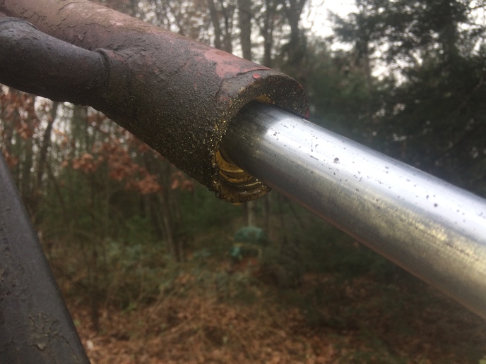

Many moons ago I acquired an IH 300 utility with a loader on it. I have since gotten rid of that tractor and adapted the loaded to work on my 1950 H and is powered by the belly pump. It works well for what I need.
The cylinders have started to leak and I want to replace the seals in them. I haven't pulled these older cylinders apart, and I don't know where to get new seals for it. Is there an online source to buy seals? Maybe napa has them?

Napa or local hydraulic pump,cylinder rebuild shop. Or someone who makes hydraulic hoses in your area can generally help.

Baum hydraulics
https://www.baumhydraulics.com/home.php?

I will second Baum Hydraulics, but get the phone number and call them. The representative for you area will make you a better deal than the on line price, plus he can answer any questions you have. He will need to know the diameter of the ram, the inside diameter of the housing, plus what kind and how many seals are in it.

good afternoon pretend farmer, if your going to do the cylinders the hoses especialy on the bucket tilt cylinders look pretty rough, now would be a good time to change them as well. if you've ever had a hose blow especialy under load you will understand. there's nothing like getting a hot hydraulic oil bath to wreck your day! and I speak from experiance Laughing
