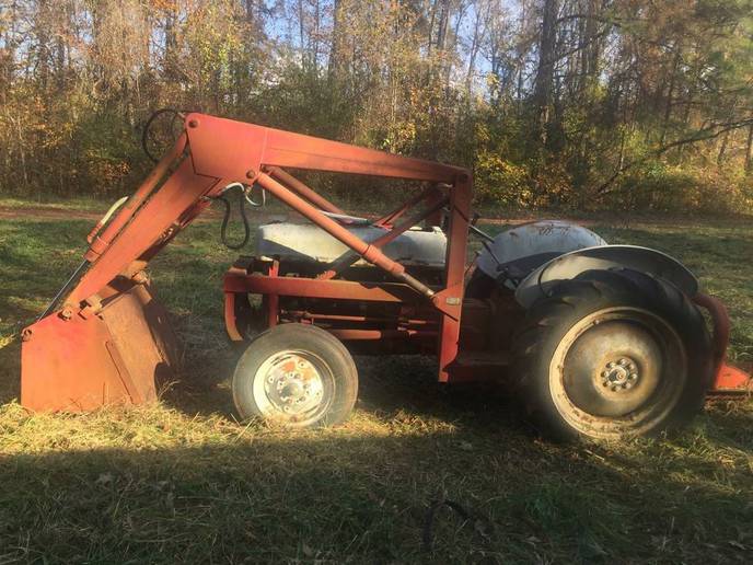

Anyone have a Ford model 19-105 front end loader on their NAA tractor? I found one I am looking at for $450. Seems like a really good price to me. It needs some hoses, paint, and TLC. I am hoping to make the deal later today. Here is a picture of it on an 8n. The literature says they were made for N's, NAA's, 600's and 800 series tractors. I found a manual for it on-line already.

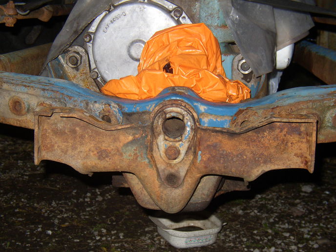

Here is a picture of the front of mine, right now. I have the tractor completely stripped down, getting it ready to paint.
Pat
What does the pump drive look like. And what do I need to do, to connect it to the crank?

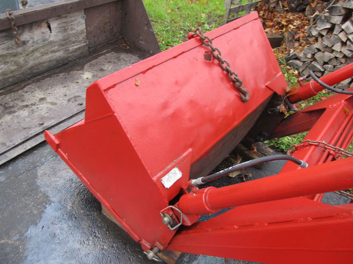

Here is a picture of the pump drive parts. Here is the model as I have. Not mine, but a better picture than I have of mine.
Back to top
View user's profile
Hdonly
Regular
Joined: 04 Aug 2017
Posts: 97
Location: Florida
Report to Moderator
PostPosted: Fri Dec 08, 2017 4:35 pm    Post subject: Re: Ford model 19-105 front end loader Reply to specific post Reply with quote
more

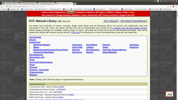

The pump came with my loader. I haven't looked at it that close yet. Looks like the pump drive parts can be had right here on the site. I know the parts for my tractor are here. I am going to try to post the manual I found for my loader. I couldn't post the link so look at this screenshot and go to the address and see if you can find anything that helps you.
Back to top
View user's profile
Hdonly
Regular
Joined: 04 Aug 2017
Posts: 97
Location: Florida
Report to Moderator
PostPosted: Sat Dec 09, 2017 7:29 am    Post subject: Re: Ford model 19-105 front end loader Reply to specific post Reply with quote
Sorry, that didn't work. You can't really see the address.
Just google "NTC Manual Library " and see if that will take you to it.
