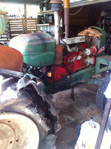

So I finally made abit of space in the shed to have a propper look at this engine.
It took a bit of a push from another import but got it headed towards some shade to work in.

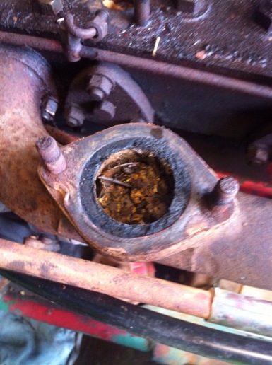

Exhaust manifold seems to be half filled with mud.

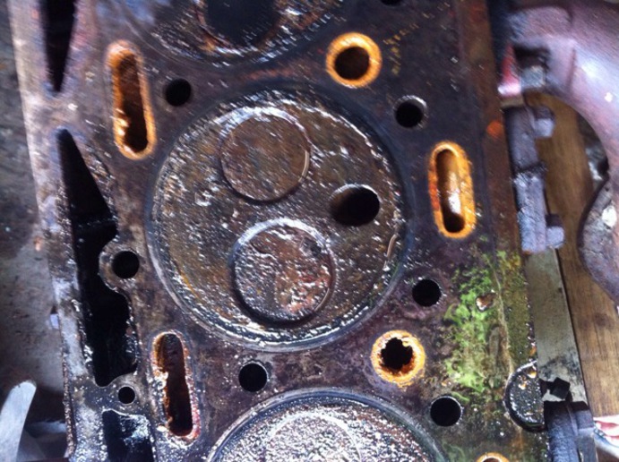

Got the head loosened and then off, I have certainly seen worse, never owned it.
