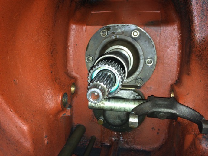

I have my tractor split apart but do not know what the release bearing end should look like. In pictures I see 2 release springs on each side of the release bearing and mine has none. Also, my release bearing is not even sitting in the release fork and should it be sitting in some kind of hub? I also do not see a place to even anchor springs back at the transmission if it did have them. Does anyone know what that end of an 861D should look like? Thanks

pomester
Regular
Joined: 04 Mar 2016
Posts: 381
Report to Moderator
PostPosted: Sat Dec 09, 2017 10:21 pm    Post subject: Re: Ford 861D clutch Reply to specific post Reply with quote
I am not sure I understand what you're asking exactly, but here are a few pictures from a 9XX that I believe is the same clutch/release bearing/carrier as yours, maybe they will help -

PostPosted: Sun Dec 10, 2017 4:52 am    Post subject: Re: Ford 861D clutch Reply to specific post Reply with quote
Thank you that does help. I do not see them in these pictures
either. I will keep digging. In the diagram for a 4 speed it
show 2 release springs running on each side of the release
bearing. The springs connect to the release hub up by the
bearing but I have no were to connect the other end. Since I
do not see them in your pictures I may net need them for
soem rason. Thanks again.

showcrop
Tractor Guru
Joined: 13 Dec 2000
Posts: 20660
Location: Chester NH
Report to Moderator
PostPosted: Sun Dec 10, 2017 5:05 am    Post subject: Re: Ford 861D clutch Reply to specific post Reply with quote
CVPost-P012281 wrote:
(quoted from post at 05:52:52 12/10/17) Thank you that does help. I do not see them in these pictures
My 961 is just like Pomester's. No spring anchor on the transmission wall.

sotxbill
Tractor Guru
Joined: 14 Jun 2003
Posts: 5538
Report to Moderator
PostPosted: Sun Dec 10, 2017 7:01 am    Post subject: Re: Ford 861D clutch Reply to specific post Reply with quote
The only return spring,, is the one on the shaft shown in the picture. this spring does all the work, so be sure you have it on, if not the other style.

Kurt-NEPA
Long Time User
Joined: 05 Mar 2009
Posts: 1204
Location: Tunkhannock, PA
Report to Moderator
PostPosted: Sun Dec 10, 2017 8:40 am    Post subject: Re: Ford 861D clutch Reply to specific post Reply with quote
Here is a few more pics if they help.
The throw out bearing with the two springs fits the 4 speed. The 5 speed uses a spring on the shaft as in the pics.
The clutch pic is a Tisco clutch. When I looked several years ago it was the only new clutch I could find. Available from all the usual sellers and on YT. You can get a kit with the TO and pilot bearing.
