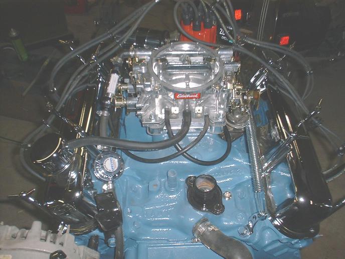

"Guys on my old truck forum get a little crazy when someone suggest
blasting a carb due to getting the media in the small nooks and crannies."
I've heard that many times, and I won't argue with that point.
It does beg the question of whether they are cleaning all the nooks and crannies
out to begin with though. If they're not, they're not doing it right to begin with.
Soda blasting is easier to clean out, but it still has to be cleaned out.
Then there are the questions of what media to use on which types
of metal. The old cast iron Marvel Scheblers vs, say, a Holley or Carter.
I'd hate to sandblast my Edelbrock. Wink

PostPosted: Sat Dec 09, 2017 10:53 am    Post subject: Re: Where to get the best Carburetor Kit? Reply to specific post Reply with quote
Nice looking (SBC ?) Royce. Are you putting that on your N?
Yeah, I reckon I need a kit, I screwed the idle adj. in all the way and she still idles fine.
