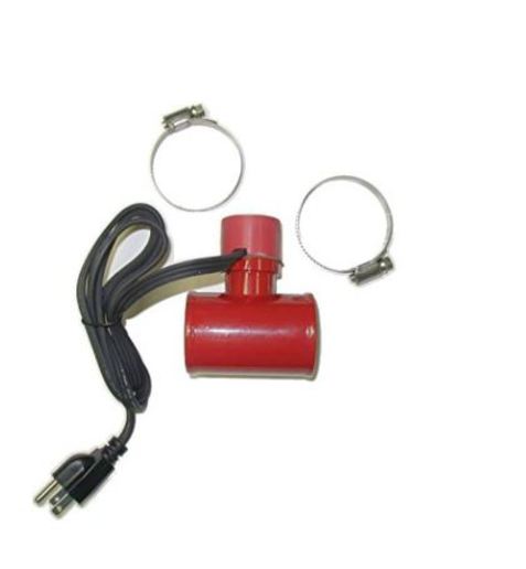

I have used lower radiator hose heaters for 50 years in Mt. It gets pretty friggen cold here if you didn't know. They work great. They heat the coolant in the block if you follow the directions for installing them. Don't over think this and worry about the thermostat. If it gets warm enough it will just open.

I concur with Jimmyjack. Call the lower heater a joke but the joke works at -20F here in WI, IMO the Katz lower radiator hose is the only way to go. Some of the nay sayers think the coolant must be circulated for it to work. I plug mine in about an hour before starting at -20F. Touch hand on head and it feels warm. Tractor starts right up like 40F. A little tight fit installing but well worth it. I tried a magnetic one on the pan and really not a good place on the N to put and did not seem to heat much at all. So try to take it off while it is hot. Forget it! Again my opinion and experience.

I didn't get any responses in regards to Kat's, so I just picked one up to try (200 watt). .....Well, not worth it. It simply does not heat enough (it was 10 degrees out). Maybe on some thinner steel oil pan or something. I doubt the 300 watt would work much better.
