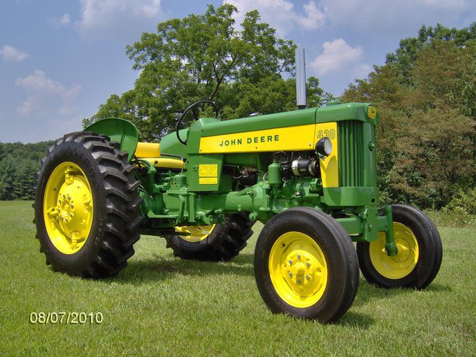

I did this '59 430W in 2008 with John Deere Classic Green, reducer and hardener. It's kept indoors but after nearly 10 years it still looks as good as it did when I finished it.
