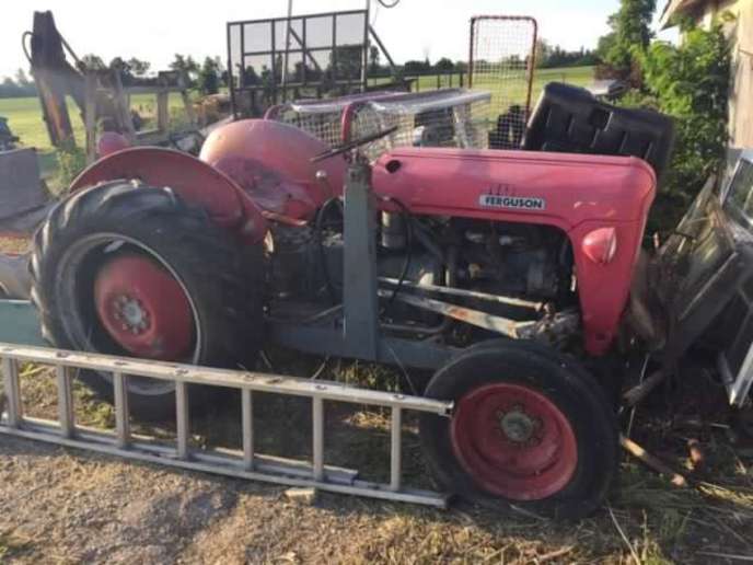

Will a to 35 hood fit a to 30? If anyone has don this let me know, Thank You and MERRY CHRISTMAS!

Never tried it, but looking at photos, the 30 hood is longer, comes further back where it meets the dash.
Now if you had some of the 30 hood, it "might" could be grafted on to the back of the 35 if you are willing
to do some, a lot of, body work!
But, could be other differences, just guessing.

I don't know the answer for certain, but I do know the 30 and 35 are different lengths from grill to rear axle, having tried a loader on
both (it only fit the 30). So I'm guessing the hoods are probably different length.

looks so judging from the different dash. Think I will look for an old 30 or 20 hood and cut it up a bit. Just getting ready for the springtime projects.

I have never done this myself,so I do not know how well it works. The 35 hood is a
little longer then the 4 speed Ferguson hoods,so would probably need some
triming. Here are a couple of pictures of a Ferguson 20 with a 35 hood.
