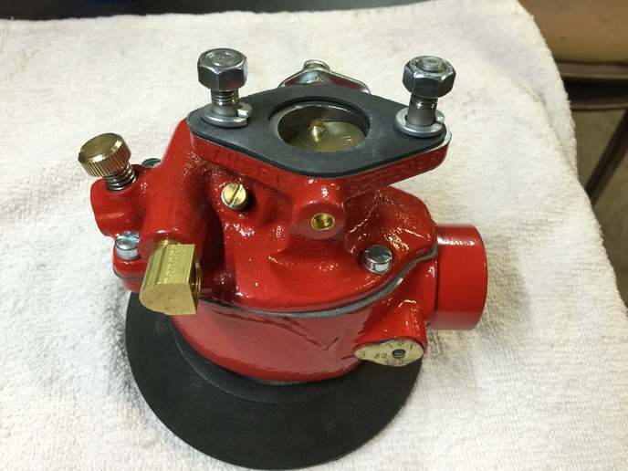

The original carb would have been a Marvel Schebler, but without
checking my books I'm not sure which one it would have been.
They're fine carbs and can be rebuilt as needed.
If you don't have any luck rebuilding it, I rebuild them.
Here are a couple of pictures of ones I've done.
I would also be willing to help you rebuild your own.
