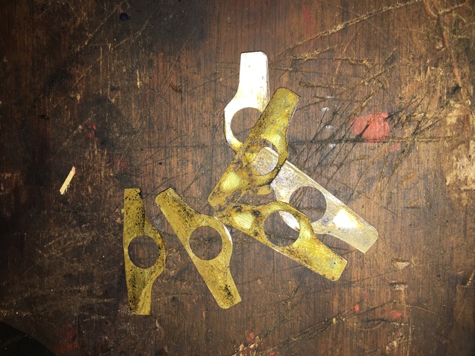

Don, attached are pics of my serial numbers and some of the rod bearings. I don't plan on replacing the rod bearings. They each had the original 6 shims ? I thought I would check them with plastic guage. I not sure about the hammer method mentioned in another post. Dick

Thanks Dick for posting the pictures of the rods and caps, Babbitt bearing. Makes sense to check with plastigage. Enjoying the pictures of your project gobble

Well, your DC has the original engine and it is a 1953 model. I'm pretty sure that is the way it came right from the factory with 3 7/8" sleeves and pistons. If it had been upgraded to 4" sleeves and aluminum pistons it would be stamped AP either before or after the serial numbers on the block. I think your tractor proves that t least some early 1953 D series were factory equipped and sold with the 3 7/8" cast iron pistons. Thanks for helping to clear this up. Don

The rod cap in your picture looks pretty good. I've seen them with junks of Babbitt missing.

Like most farm kids I grew up helping dad in the shop. The way I was taught to adjust babbitt bearings is as follows;
Bearings have to be adjusted 1 at a time.
Remove shims until tightness is felt but engine can still be rotated by hand. This is considered "0" clearance. Now add shims needed to have the required clearance according to the factory specs. Repeat on each bearing.
Dads reason for this method was to make sure there was enough clearance for the full 360 degree rotation if the bearing or crank had worn out of round. I remember hand cranking many many rounds before he would finish adjusting all of the bearings. I bet there are others on here that use this method.

Nick!! 25 years ago that is the way my Dad & I adjusted the Rods & Mains on our '53 DC-3. Except Dad was on the crank & I was underneath, subtracting & adding shims. He would pull against the crank and by his feel we adjusted the bearings. At that time, oil pressure went from 30 to 40, where it still is today. I use 15W40. Dad was 85 at the time.

LOL ,.. Nick ,,. I was the Cranker Too Back in Those days ,.. I would bet there are still shims like that hanging on a nail next to the grainary at Dads place,,..

That is the same procedure we used last Spring on our DC3 LP. I was the cranker. LOL Don
