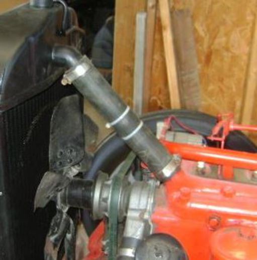

Oh, 60/40 coolant mix? And the thermostat is in the housing for the upper radiator hose?
Not sure where you're located but 50/50 is good to -30 degrees.
Thermostat goes in the upper radiator hose. Pointy end (sensor goes toward the block. Purpose of tywraps in photo are to keep the thermostat from traveling up the radiator hose.

PostPosted: Wed Jan 03, 2018 4:31 am    Post subject: Re: 8N with bucket Hood removal Reply to specific post Reply with quote
I use a 50/50 mix here in Michigan.
The thermostat is in the upper radiator hose itself on these.
They're a pretty tight fit, but I still put a hose clamp around
the outside of the hose to keep them from moving.
