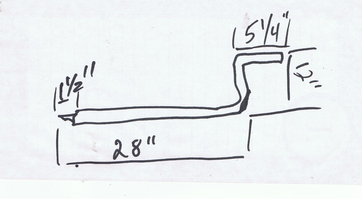

Does anybody know the dimensions for a 1953 Case DC hand crank? I found one for sale that shows 9/16 diameter at the crank end but does not specify case. Perhaps someone has one they can measure?

Don't know for sure but a vac is about 9/16. As I remember from my youth a dc is closer to an inch.

Perhaps 9/16 across the flat part of the
tip. Rod itself is more in vicinity of 1
inch, or a little under until you get out
past the bend.

The hand crank for my DC measures 1" in diameter.

CVPost-Mathias NY wrote:
(quoted from post at 22:24:41 01/05/18) The hand crank for my DC measures 1" in diameter.
ACG I think drew this .CM

PostPosted: Sat Jan 06, 2018 6:38 pm    Post subject: Re: ISO 1953 Case DC Hand Crank Reply to specific post Reply with quote
there you go.CM

Thanks everyone for the help and thanks Chuck for the detailed drawing! Now I know what to look for.

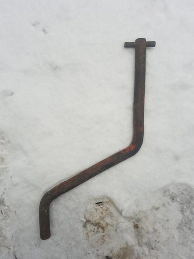

I did get what looked like a hand crank with the tractor but it doesn't fit. Oddly enough, it's painted case orange to match the tractor. Not sure what it is though. Would it possibly be used elsewhere for this make/model?

PostPosted: Sun Jan 07, 2018 2:44 pm    Post subject: Re: ISO 1953 Case DC Hand Crank Reply to specific post Reply with quote
Here's a shot of the full crank

and does anybody know if the crank off a Case SC will work? Found one on ebay

the full picture of the crank is a crank for a V series tractor. Get a flashlight and look through holes where the crank goes and you will get a better ides of what you need.
