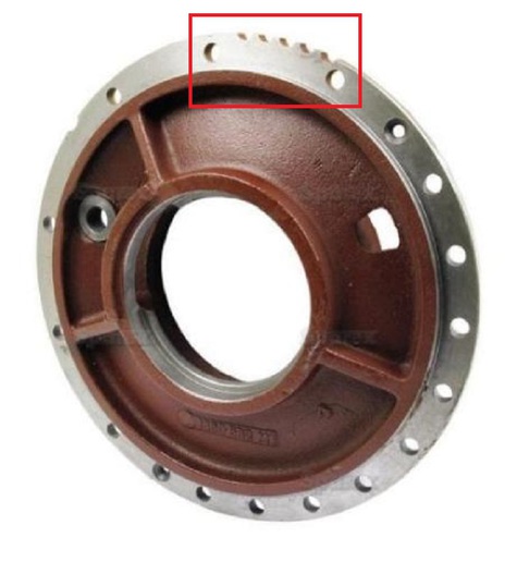

I am looking at a 1978 255 without multipower. Unit has unknown hours but appears to be in good shape without an overall rattle can paint job.
Can somone tell me what year Massey started putting wet discs in the 255? I confirmed that this tractor does have the larger 236ci engine and no multipower but am unsure of the brakes.
Tires are loaded and I am not sure I want them loaded. Is there a way to unload them while still being environmentally responsible? Just don't need the weight as I won't be using a loader. Do loader tires normally mean it was a loader tractor. I guess the clutch was replaced.

On a tractor with wet brakes the plate between the differential housing, and the axle housing will these little notches in it (the dry ones don't).
