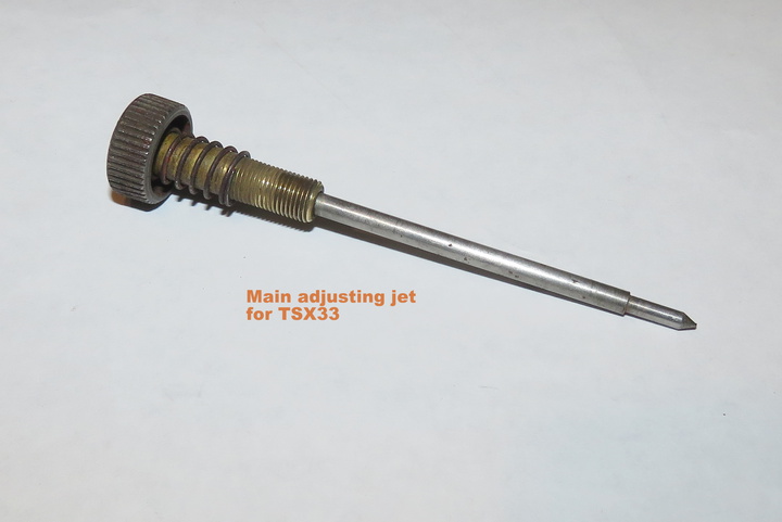

Wondering if anyone has the thread size and pitch size on the main adjusting needle on a MS TSX 33 carb.

1/4-40

Yep, 1/4-40-UNS
I assume you're chasing threads in the cast. If you're
trying to fix the needle I probably have one you could have.
I know some people don't like the ones that come in the kits.

PostPosted: Tue Jan 09, 2018 6:22 pm    Post subject: Re: TSX MAIN needle Reply to specific post Reply with quote
Royse wrote:
(quoted from post at 19:21:20 01/09/1Cool Yep, 1/4-40-UNS
Right, got a couple of good needles included the one in the photo.

Yes, UNS -Unified National Special. Also, FWIW, the thread size on the male fuel line fittings and the female threads on the carb brass elbow inlet and the Fuel Sediment Bulb assembly are 7/16-24. I have worked on fellas carbs where they tried to 'fix' or chase these threads with the wrong tap and end up with a hacked up mess with severe leaking issues.

I have one but it is broken, otherwise I'd loan it to you. 1/4-40 UNS is a special thread pitch size as you know. They are available -see LINK below...

I got a 1/4 40 UNS tape ordered,
