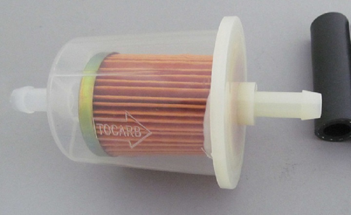

After two big long storms here, my dirt roads were in pretty bad shape. I went out with the 202 with a box blade on the back. It started running bad with a load on it. It wouldn't pull a full box blade up a hill.
I go it home and figured it was either spark or gas. First thing I did was pull the bottom drain out of the carb bowl. The gas just came trickling out, not like it should. So I then pulled the gas line off the carb and it ran fine into a mason jar. So I was sure it was that brass elbow with the filter on it in the carb. I pulled that out and it was very dirty. I held it up to the sunlight and couldn't even see through it.
Then it dawned on me that I had one of those as a spare part for my 8N. Got that one out of the shed and sure enough it fit.
Back in business. Why can't all fixes be that simple?

When I have that happen to me I just spray them out real good with carb cleaner spray and then blow them out with air and I am good to go again

I put one of those plastic see thru inline fuel filters between the tank, and carb on my 2135 industrial (best thing you can do).

If you use the correct type yes they work but if you use one made for a fuel pump they will cause more problems then the yare worth. I have thrown at least 30 of them as far from the tractor as I could because they caused to many odd problems

I've used ones like this for many years, never had any problems with them.

A filter in the tank, one in the bowl, another in the carb. It's a crap shoot which one stopped up and that's why I use an inline plus a ball valve.

Your lucky then I have had those cause so many problem it is not funny. If a person does not run there tractors with a full tank of gas those filter will cause many problems
