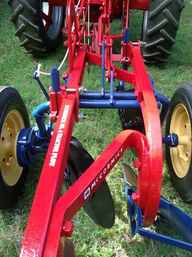

In the spring I will be starting in to re model re finish a Little Giant #8C (Canaian)two wheel lift tractor trail plow.
Does any one have the correct paint codes for the following colours: ihc black, blue, "cream white cream" or impliment white and the red cerca 1940 to 1960. I will probably purchase the paint through either Napa or Car Quets here in Ontrio.

I restored this No. 4 this past summer. I used Tisco Brand paint and hardener, both available here on Yesterdays Tractor. The Red was their IH No. 50, Harvester Blue and the cream was their Case Desert Sunset. The Desert Sunset was a dead match for the original cream color I found under the tires, behind the rims and in beneath years of grease.
The vinyl decals were from Maple Hunter. I had the stencils for the beam made online

Wow,DC Sider that is a wonderfull re set to be abundantly satisfyed with.Do you have access to any of the paint"" formulas , codesfor the blue, ""white"" or black? The red I think I can take the ihc50 number in to NAPA or Car Quest and they will be able to match.I have loged you information in my orriginal plow manuel. By the way I have an orriginl 1952 manuel. It is Canadian "but" also similar to the US models.The major difference between the two is that the Canadian models were all made adjustable 9 through 12inches and the operating levers were made with an ajustment 3 point sector 1/2 way up the lever.My email is assessable.

On further looking over your photos I jut notiched that yor's is also a ""2"" wheel lift THE only addative is that your's has a fixed rear wheel, WHERE mine has none only a long rear land side

DC-Nice job on your plow restoration. Dad had two IH #8's. One we used the most was an old trip plow
converted to hyd lift. I pulled that plow over thousands of acres. That plow had that exact same color
cream on the wheels from the plant in Canton, Ill. I always called it Manila folder off-white. The #50 red
and blue are correct too. Nice job. I see too many of these old IH plows with today's #935 white wheels
and that's just not right. If you have a #60 or 70 then #935 is correct.

I have a plow like that I cleaned up and painted several years ago and I did not know there was a different color of white to paint the wheels. What paint code did you use and where did you find the decals for the plow? On top of the beam you appear to have painted the stamped letters white am I right?
