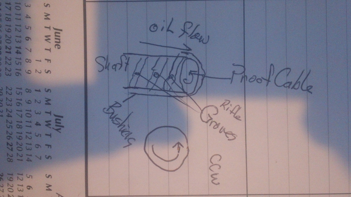

PostPosted: Fri Jan 19, 2018 11:24 am    Post subject: Re: new 8n governor will not govern. Reply to specific post Reply with quote
This is a brand new governor there are no seals, just a bushing that surrounds cable end of the shaft.
Didn't take pictures, before I put it back on, but here a crude picture do you remember, how yours looked.
I'am using an old armored cable, is that were the seal are suppose to be?????
