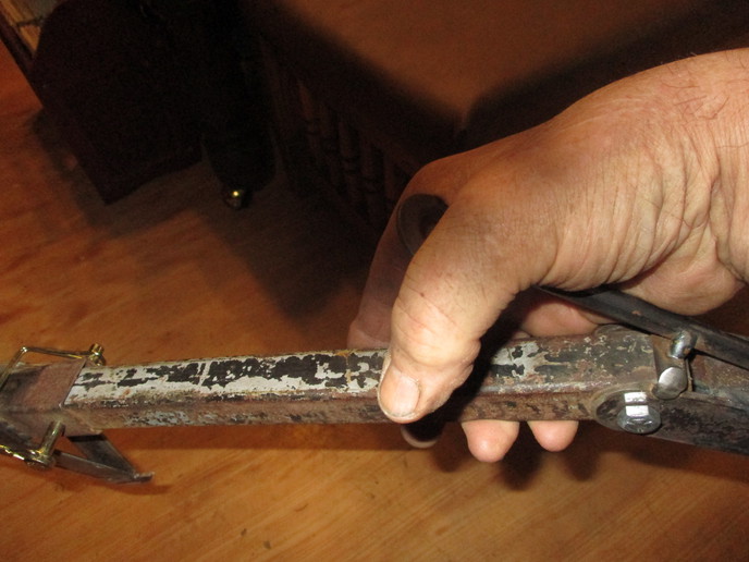

Been looking at those block grabbers that have a hose with hooks on each end. I want something for those in between blocks, 10-18" diameter that I can lift and set on the splitter.
Built this tool this afternoon from 1" square tubing. and some more scraps. The commercial grabbers are length specific and one would need a couple of them if cutting different lengths of firewood. This one is adjustable, and has a trigger to open and close the jaws. Tomorrow I will weld a rod loop under the bottom to hold it up off the block and protect my knuckles. My hand fits easily around the tubing and it is easy to squeeze the trigger with my palm and thumb to hook and release blocks.

looks good to me. I'm cheap here and just use an old set of ice tongs.

Also take a look at a brick caddy. Or brick carrier. 5hey can be adjusted from maybe six bricks to twelve at one time. I have three types. They are on Ebay as brick carriers. The design might give you some ideas. Really handy when you are laying a sidewalk. I wrapped a layer of buttle tape around the handle on mine to cusion it a little.

I like it. I used my store bought ones this week. They are limited to certain lengths.

How are you getting along with it?? Does it release as well as they say???
I still have a couple of issues to remedy today with this thing. The washer on the end of the trigger can pinch my palm between it and frame, and I need to weld a loop on the bottom to protect my knuckles, and keep my hand centered on the tool. I will post a pic of the finished product.

That would be about a 60 pounder. I can still lift them. I have to use the jib and grapple to lift the 100 pounders. I don't need to bend down near as far and get my fingers under the bottoms to lift blocks with this. Bending over and lifting these smaller blocks that need splitting from ground level is the real issue, that this should solve.

That was one design that I pondered, but the handle over the top of the bar, would have been a bit higher to get the block up onto the splitter bed and this gives me a bit more range of bite, without adjustments.
Just my over active analytical mind at work HeHe.
They used to make battery carriers like that also.

I really like it. It saves my back from hurting. I haven't been able to bend over very much in years.
I have had no problems with it releasing.
It is also very comfortable in my hand.
