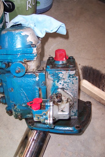

Can you post, or send me a clear picture of the side of your injection pump. I worked on the Major series, with Simms pumps, a lot, and might be able to help you.

PostPosted: Sat Dec 02, 2017 9:33 am    Post subject: Re: 1962 Dexta SIMMS injection pump question Reply to specific post Reply with quote
Hope these turn out.

I think the Simms pneumatically governed pumps on the early Dextas do not have a dedicated oil fill plug. I was told by a reapair shop to put oil in these regardless so the only way I know how is to take off the lift pump or part of it and put it is there.
Normally the pump is lubricated by the diesel fuel that leaks past the plungers in the upper pump body, but I think this is not the most efficient or best way to lubricate the lower parts.
There is a drain. There should be a pig-tail pipe on the bottom of the pump body. Excess lubricant flows out of this overflow pipe to keep the level constant, so it appears that these were designed to use diesel fuel. I have checked three Simms Pneumatically governed injection pumps and all have the pig-tail.
I am thinking of drilling and tapping for a fill plug like in the Minimec pumps used in the super Dextas. I have a conversion Minimec p4596 pump I am going to check.

PostPosted: Sat Jan 20, 2018 9:50 pm    Post subject: Re: 1962 Dexta SIMMS injection pump question Reply to specific post Reply with quote
The older units like you have were intended to be lubed by the diesel fuel that leaked past the plunger & barrels.
Things were a lot different "back then"..
Just remove the side cover CAREFULLY & drill & tap a hole & add engine oil.
Or remove the lift pump on the side of the pump & add it there.. enough to cover the camshaft.
that procedure is ok if the pump is off the machine.. but its hard to cover the cam if the pump is upright.
That being said> any oil is better than no oil..
Just use the type of oil that you run in the engine.

Just had one of these apart what you do is take off the side cover eight screws if I remember correctly you will see the springs just in front of them you will see a drain to the cambox here is where you add the oil. When full in will come out the pipe on the bottom
