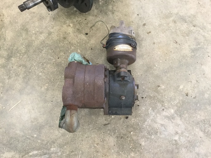

Might be easier to find a mag off an older one to put on. Can you post of picture of the dist./hyd. pump setup?

The distributor drive and hydraulic pump assembly attaches to the back of the governor housing.

Thanks for taking the time to post the pic. Everytime I hear of one of these having hyd. I always ask for up close pictures and details. I've been thinking about
putting hyd. on my 99 but I don't want it to look cobbled or tie up the pto.
As it looks I'm willing to bet you could just take the hyd. pump off and build yourself a flat plate and gasket to close up the back side.

No problem. We’ve not separated the pump yet, I’m anticipating that we might need a bearing holder at minimum. If you’d like more in-depth pictures, let me know.
