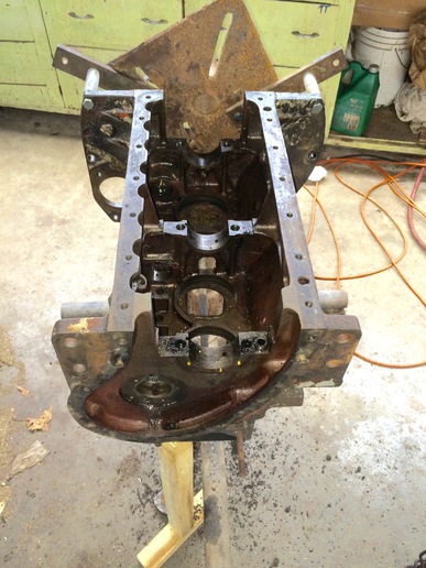

Shop time the last couple of days has revolved around installing the Sherman while I thought about and did some research on the Z-129 engine and how to proceed.
The machine shop I liked closed, my second choice has several employees out sick and wanted nothing to do with my project at this point and tried to send me 50 miles away - I visited a local firm today that restores tractors and they may be able to help me.
I had the block bare except for the sleeves - I read about sleeves falling out of these engines, but in this case they were quite tight. I had planned on the machine shop removing them for me, but now I was on my own - eBay has a seller than provides a nice serviceable puller for $113 w/shipping, but for me it would likely be a one-use item and that's about half the price of new sleeves and pistons. I sorted thru my scrap pile and found a hunk of 1" bar stock, spent a couple hours cutting and grinding a block that fit the outside of the cylinders, turned the engine upside down and supported the loose end and started with a 2# crosspein, moved up to a 6# sledge, and finally to a 12# sledge and finally got the sleeves out of the block. A good decision as the coolant jacket had a lot of scale and debris - #4 cylinder was particularly obstructed.
I guess I'll haul the block and maybe some other pieces off to the car wash when the weather moderates a bit (middle of next week according to the forecast) to start the cleaning process. I will get my parts orders ready over the weekend.
