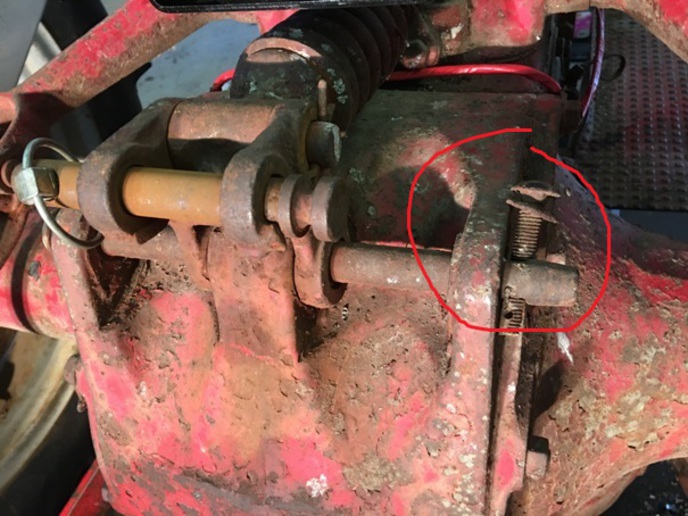

And while I am posting pics, though I know I'm new to these N's I'm guessing this is not original?
Good guess. Wink The long pin it is inserted into is original though. Many are lost.
They would be used to hold stay bars for the drawbar or limiter chains for a mower, etc.

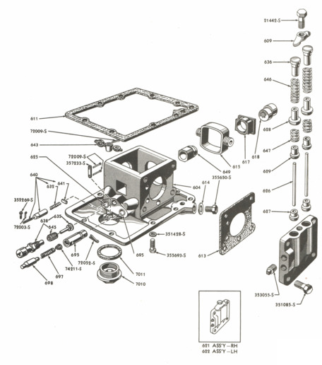

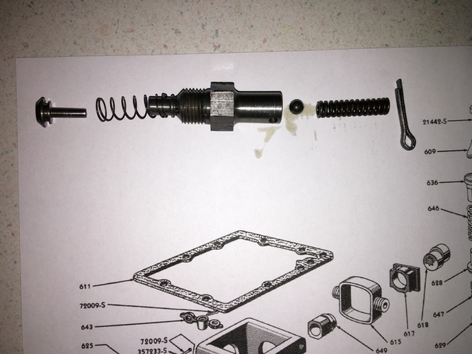

Quick question...so while removing the safety valve today I noticed the cotter key in the end of it was going to hit the control arm below it, so being that I am replacing the valve anyways I proceeded to just pull the pin out for clearance. What I didn't expect was a projectile to come shooting into my chest and onto the floor. I'm pretty confident I recovered all the pieces but I figured just to be safe I better ask. Be a pisser to get it all back together only to have some loose part foil the whole job (see photo).
And before I pull the intake/exhaust valves in an effort to clean those, is there anything else I might need to be aware of Shocked ?

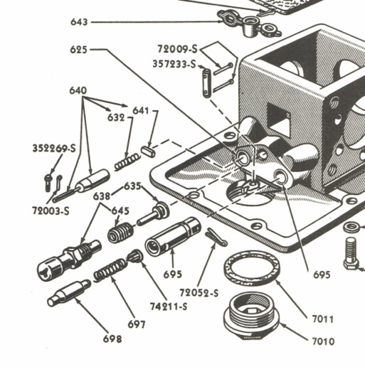

Thought I'd add this for reference...
Back to top

PostPosted: Wed Feb 14, 2018 6:15 pm    Post subject: Re: Swapping PTO Soon Reply to specific post Reply with quote
Blown Up for better identity
Have never had one apart but according to this photo, you seem to be missing the plunger that goes between the spring and safety/relief ball valve.
The control valves are spring loaded too

PostPosted: Thu Feb 15, 2018 6:22 am    Post subject: Re: Swapping PTO Soon Reply to specific post Reply with quote
Hmm, well I guess I'll have another look then. Being that that plunger would also have shot out towards me it too is likely to be on the floor. I searched all over the net trying to find a breakdown of that style valve to no avail. Heck, I was only able to find one that was photo'd still in the pump, and one other sitting side by side one of the newer style, but no breakdown of one . Good Find, and Thank You.
