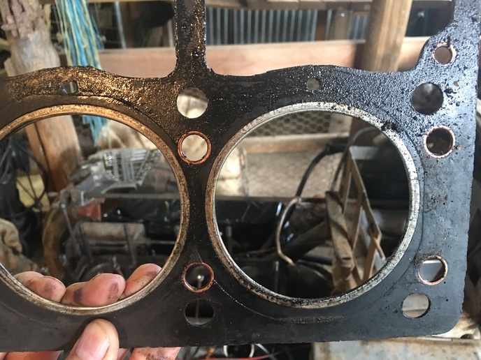

Initially I had white smoke coming from my rocker gasket. I pulled the engine apart, flushed the cooling system, pulled off the head, put on a new head gasket, manifold gaskets, new plugs, oil change and filter and a liquid rocket gasket because I did not think the cork was working. There was some carbon deposits but nothing that looked broken. It all went back together with no extra parts. It started at the first turn of the key and everything seemed good.
When I did some work with it, I noticed it was overheating. So I checked the fan direction, hoses and the thermostat. All were good.
I let it sit a while not knowing what to do. It was inside. After about 6 months, I ran it again. This time it overheated and I got white smoke out of the oil top-up and rocker. Carbon on all plugs.
I took the engine apart again and there is rust in the rocker cover, and water was in the head and oil pan. Oil milky. There are no obvious cracks in the block. The water is siting between the cylinders and not draining out.
I did purchase the new head gasket on ebay and it was not fully copper like the old one. I was planning on purchasing a new copper head gasket and trying it again. I might add that the replaced gasket looks fine.
Could someone perhaps tell me what else I should look for?

Not familiar with the TE engines, but in the bottom photo, the copper rings that are partially caught under the top of the liner and hanging into nothing on the other side...
That may be the way they are supposed to be, but doesn't look right. Is that possibly the wrong gasket?

PostPosted: Mon Mar 05, 2018 5:36 am    Post subject: Re: Water in oil no obvious cracks - help Reply to specific post Reply with quote
CVPost-Steve@Advance wrote:
(quoted from post at 06:17:14 03/05/1Cool Not familiar with the TE engines, but in the bottom photo, the copper rings that are partially caught under the top of the liner and hanging into nothing on the other side...
Although I prefer the copper ones, I have used this type as well.

PostPosted: Mon Mar 05, 2018 7:24 am    Post subject: Re: Water in oil no obvious cracks - help Reply to specific post Reply with quote
Absolutely DO NOT ROTATED CRANKSHST. Sleeves shall brake loose of the bottom Siamese's sleeve gaskets. Locking plates must be installed before crankshaft is ever rotated.
If you assemble engine with OIL PAN off, spark plugs removed, you shall be able to see if it's a coolant leak from the top end or a coolant leak from the lower Siamese's gaskets:
Coolant leaking into oil pan from between pistons and sleeves or coolant leaking into oil pan from faulty lower sleeve Siamese's gaskets.

PostPosted: Mon Mar 05, 2018 6:17 pm    Post subject: Re: Water in oil no obvious cracks - help Reply to specific post Reply with quote
To confirm or eliminate the liner seat gaskets , often also called ' spectacle ' gaskets remove the sump first . When this is off fill the galleries with water and place newspaper on the floor under the engine . Any slow weeping or dripping will make the newspaper pucker and confirm that the gaskets have failed .
