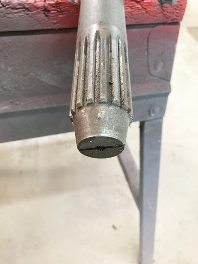

royce were you able to snap any pictures of the axle(s) you have?

"royce were you able to snap any pictures of the axle(s) you have?"
I didn't, but if you're still interested I'll get them tomorrow evening.

PostPosted: Thu Mar 08, 2018 8:44 pm    Post subject: Re: Replacement parts Reply to specific post Reply with quote
Sorry for the late reply, mass and rosary took longer than
expected today. I did get you a couple of pictures though.
Good or bad.

PostPosted: Fri Mar 09, 2018 7:58 am    Post subject: Re: Replacement parts Reply to specific post Reply with quote
Can't tell much from the pics.
Is the hub in good shape and is it tight?
Splines on the axle good shape?
Are you selling as is? Meaning axle, hub, brake plate, dust plate?
How much are you asking?

PostPosted: Fri Mar 09, 2018 5:31 pm    Post subject: Re: Replacement parts Reply to specific post Reply with quote
I never tried to take the hub off to inspect the splines, just pulled it
out of the tractor as you see it. The hub-nut is definitely aftermarket.
It is one of the two piece replacements with the locknut.
Like this one.
Everything goes, will even include the brake shoes that were on it.
They look to be in very good condition. Not sure what I did with the springs.
Next week I can take it apart and tell you more about it if you'd like.
Or you can have it as is for $40. That's the price of the locknut.

primarily I want the hub and axle (bearing) to be in good condition. If those three things are in good shape I'm happy, the rest is gravy. I have an axle nut, break plate and bearing retainer. Are you able to loosen the axle nut to see if the hub is tight or loose?

PostPosted: Mon Mar 12, 2018 7:29 pm    Post subject: Re: Replacement parts Reply to specific post Reply with quote
I was gone all weekend and then back to work today, so I haven't
looked at it. If you're trying to replace only the worn parts, do you
know which of yours are worn? Is it the hub, the axle, or both?
The hub is softer than the axle and often wears out first.
