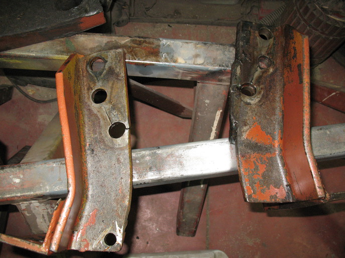

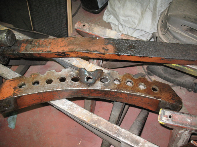

I took off and cleaned up the bent up draw bar assembly off the m5 tonight and found the draw bar had been installed upside down Rolling Eyes I think I just found the reason for all the bent and cracked brackets Crying or Very sad checked in the manuals and yup it's upside down. the 1" pin that go's through the draw bar and up into the housing has a nice S bend in it. looking at all the cracks and bends in the side brackets i'm going to just build new ones, using 1/2" plate using the old brackets for patterns minus the bends and cracks Laughing the top pic is the draw bar the way it came out!

finished!! I believe it was done to lower the hitch? when you look in the parts manual it shows it bent like that, and when you look at how it bent the 1" pin it makes sense.

wgm the 2 bends you see are factory bends, but someone installed it upside down?? why I not sure, mabe to lower it down or just a mistake installing it? but installing it upside down I believe is what twisted and cracked the 2 side brackets and put the bend and cracked the curved plate the draw bar slides on. as you can see on the 1" pin it put a nice S bend in the pin not sitting sguare to the pin.

good morning tjv, thank you for the heads up on the roller slipping off the slide bar, I will be keeping an eye on that! my friend Erick and I where looking at the 2 side brackets and can't figure out why mm did not make them wider at the base that bolts up under the tractor, as you can see in the pic the bolt holes are right tight to the edge??? so he's going to be building the 2 new ones about an inch wider and using better steel. I did go out and look at the other m5 I have and there is no sign of bending or cracking on it but the draw bar is installed properly not upside down, which I believe is the cause of all the damage.
