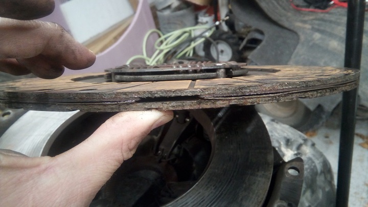

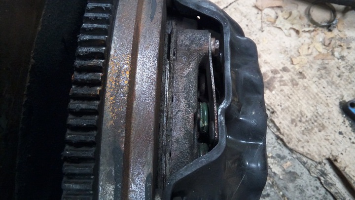

Ok, I got a little farther on my basketcase 3400 this weekend. I removed the old engine to replace it with a new (used) engine. I will need to swap the clutch onto the new engine. When I looked in the bell housing, I noticed a few broken plates, a bolt and some sort of cap or plug? After looking at the clutch, I realized the bolt had come loose from the clutch cover and the spacer plate probably swung out and hit something, causing the plate to break. It looks like another one was working its way out as well. I cannot figure out what the cap or plug is, any idea?
Now another question. I was thinking while the clutch is accessible, I should service it. I've never rebuilt or tore into a clutch assembly before, so I don't know what parts should be checked/replaced. I would guess the clutch disc and maybe pressure plate? Is that correct and is there anything else? Just by comparing my clutch to the parts book, it appears I have a 3400 single clutch, which is different from the 3000 single clutch. My parts book shows there is a 12" and 13" disc and plate for the 3400 single clutch. I assume I need to measure the diameter of the disc, and to the best of my abilities without disassembling it, it appears to be a 12". Looking at Yesterdays Tractors parts website for the 3000 series, it shows an 11" and 13" clutch. I'm guessing they don't have the clutch parts for a 3400.
I guess long story short, can you tell what shape the clutch is in with the pictures? If it looks like it needs it, or if you generally recommend rebuilding it, what parts do I need to check/replace? Thanks for any help

The clutch size is classified by the nominal diameter of the disc. At first glance it looks like a 13" based on the finger design, but
measure it to be sure, because that pressure plate only has 12 springs in it instead of the usual 16.
I have no idea what that cap plug is, but I can tell you that it did not come from the clutch.

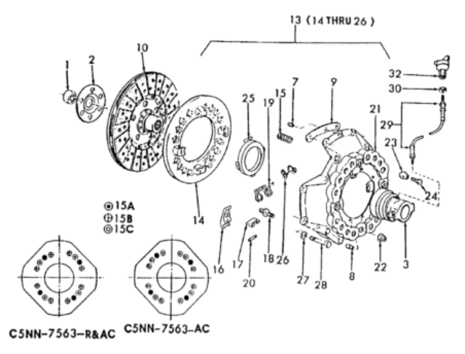

When you say clutch assembly, what does that consist of? Is that number 13 in the picture below? If so, what is the reason to replace the whole assembly and not just the pressure plate? The spacers you talk about are number number 9? That is the plate that was broke on mine.

The pressure plate is replaced if it is warped or has deep grooves in it, otherwise it can usually be re-used. As for the disc, if it has a
lot of lining left, and the springs in the center are tight, it can be re-used as well. I'd definitely replace both bearings though.
#13 is the complete pressure plate assembly. While it is theoretically possible to replace the pressure plate #14, it is usually not cost
effective to do so. In addition, you would have to have the proper tooling to disassemble and readjust the assembly once you have it back
together.

Item 13 is the complete pressure plate
On your's it looks like some bolts came loose, a new spacer and tightening the bolts might fix it, but it's not a easy job to split theses tractors and even harder if it has a loader.

Ok Destroked, below are some pictures of the clutch disc and pressure plate. I wasn't sure exactly what needed to be shown so I included a few different angles. The pressure plate does seem to show some rings on it, but there really isn't any depth to them, as I tried to show with close up and the ruler. I don't if that is enough to warrant a new pressure plate or not.

Reason I asked for the photo's was the cleanliness of the pressure plate in the first photo's, I can still see the paint on the springs.
This lead me to think the clutch may have been replaced in the recent past.
The pressure plate looks good and the clutch disc appears to have a good amount of lining material left on it, as evidenced by the depth of the rivets to the top of the lining, check the damper springs, if their loose and floppy replace the disc.
I don't normally recommend reusing a clutch and p plate but most used ones I've seen had wear on the disc and burnt spots on the p plate. That one looks good, if it where mine and the damper springs looked good, I'd get a spacer plate and put in back in expecting to get several years of use out of it.
This is just a shot in the dark, but take a look at the back of the starter, I'm thinking some starters may have had a cup plug in the end of the drive housing to help keep dust out of the bushing.
