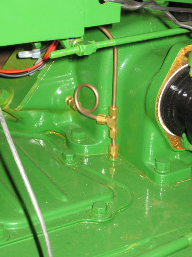

PostPosted: Mon Apr 16, 2018 3:53 am    Post subject: Re: John Deere 630 camshaft gear Reply to specific post Reply with quote
CVPost-JD 630 wrote:
(quoted from post at 18:17:07 04/15/1Cool I would like to see exactly how you did this, such as where you got the supply and where and how you entered the governor housing. I am convinced that the idler caused it all.
thank you.
Oil pressure gauge sender line to a port drilled and tapped into the idler shaft .

PJH
Tractor Guru
Joined: 26 Apr 2009
Posts: 5076
Report to Moderator
PostPosted: Mon Apr 16, 2018 6:00 am    Post subject: Re: John Deere 630 camshaft gear Reply to specific post Reply with quote
Here's a picture of an external oiler that I added to my JD 50. If you have the governor housing off of the tractor, you can drill straight through the idler shaft bore from the left (open) side. There is a convenient dimple in the end of the bore to center your bit. I guess you could do it on the tractor, but the drill cuttings would worry me. The lines are standard brake line from an O'Rielly's store. The fittings are off the shelf from a good hardware store. The whole project probably didn't cost $20.
I've also done this to my 630 - same exact scenario.

JD 630
New User
Joined: 27 Jan 2018
Posts: 4
Report to Moderator
PostPosted: Mon Apr 16, 2018 9:15 am    Post subject: Re: John Deere 630 camshaft gear Reply to specific post Reply with quote
Thank you for the fast reply, thought about using oil pressure to gauge line but thought it may affect the pressure to the gauge. I will copy your installation and hope that will cure my problem.[/code]
