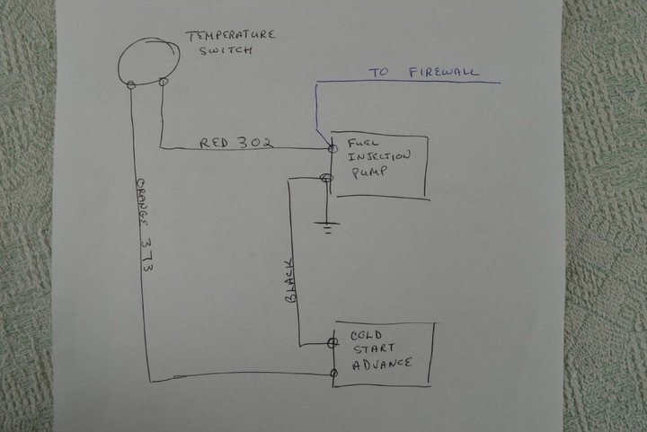

Turns out the tractor is equipped with a cold start advance. It's not even shown on the wiring diagram I've been working from. Anyhow... from the Stanadyne web site: "By advancing the fuel injection timing during cold engine operation, combustion efficiency is improved and white exhaust smoke is minimized. Once the coolant temperature is sufficiently elevated, the injection timing and advance functionality are returned to normal operation." I think that explains why the tractor starts and runs fine once the engine warms up. Here's a link to the Stanadyne web page. There is a detailed explanation of how this works as well as a nice drawing.

PostPosted: Wed May 16, 2018 5:13 am    Post subject: Re: John Deere 5210 won't stay running Reply to specific post Reply with quote
Here's a drawing of the circuit.

PostPosted: Wed May 16, 2018 5:16 am    Post subject: Re: John Deere 5210 won't stay running Reply to specific post Reply with quote
How do I check the cold start advance? Swapping parts is a little pricey. The coil for the cold start advance is about $100, and the whole assembly is $500+. Can anyone offer some advice?

PostPosted: Wed May 16, 2018 5:39 am    Post subject: Re: John Deere 5210 won't stay running Reply to specific post Reply with quote
AJAkron wrote:
(quoted from post at 08:16:44 05/16/1Cool How do I check the cold start advance? Swapping parts is a little pricey. The coil for the cold start advance is about $100, and the whole assembly is $500+. Can anyone offer some advice?
The cold start advance is NOT the issue with your tractor "dying".
It's purpose is more for emissions control than as a starting aid.
The sensor (with 2 wires) sometimes fails and blows the fuse that powers it and the fuel solenoid and fuel pump (if so equipped).
If the sensor shorts and blows the fuse, the engine stops, and that's it 'til the fuse is replaced and the cycle then repeats.
If you have done as TimS told you and unplugged the (2 wire) sensor and it starts and later dies, that further proves the cold start has nothing tom do with your problem.
Once again, the "cold start solenoid" MAY help a little with a quicker cold start, but as soon as the engine is running, it does NOTHING but (hopefully) make the exhaust a little cleaner.
Your problem is one of two things, either the fuel shutdown solenoid is "flaky"/thermally sensitive, or something in the electrical circuits of the tractor is cutting power to it.
Try this... connect an unpowered test light between the terminal on the fuel shutdown solenoid and chassis ground, does the light stay on when the engine "dies", orm does it shut off indicating a loss of power?
You can also connect a jumper lead from a 12 Volt source to the fuel cutoff solenoid, and verify that the engine continues to run with as long as the jumper is connected.
If that works, you'll need to figure out where power is being lost in the "run" circuit.
Might be as simple as a failed "ignition" switch that's failing to keep the fuel solenoid energized as the key returns from "START" to "RUN".
