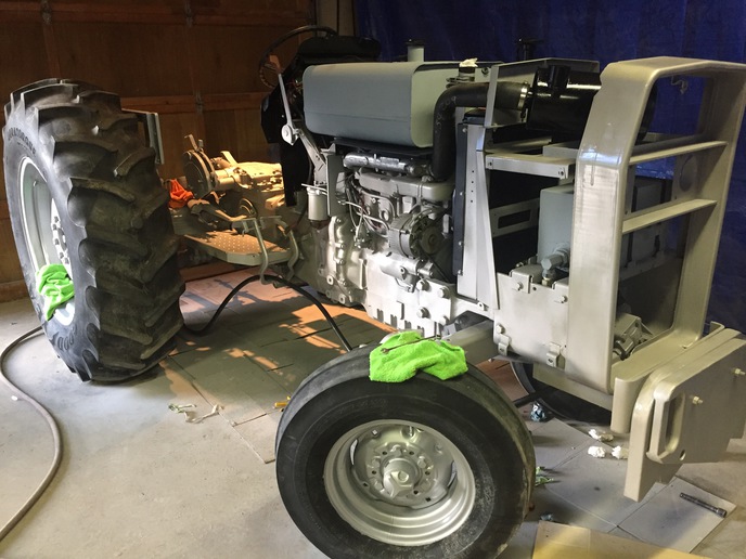

I have a couple more questions as I go.
My tank never had any sort of pad or any material under it before now in investigating some of the fuel line connections I'm seeing diagrams showing a pad under it. Curious about how thick it is? I'm hoping to find something local to put under it. I guess some temp resistance will be needed, nothing that would melt? HD belting or matting seems like it might be the ticket?
My other question is if there is a fuel olive used at the fuel tank shutoff to fuel line connection?
Thanks for any and all help.

I did pick up fuel and oil filters today and ordered both the air filters. My 'ebay' rad hoses don't fit so now I'm trying to hunt down something local. I've got to get two more hydro hoses made up to finish up the aux hydraulics. For now I'm eliminating the three spool valve under the footbed. It was leaking and will be simple enough to add in the future again if I have a need for it. I have a modern loader tractor so I don't foresee putting a loader on this one in the near future.
I am struggling with the routing of the hydro hoses still. Hoping to pick up a filter for the return line tomorrow and that I can get it to mount kind of in front of the fuel filter and a bit lower. And then I can use that to help route/cleanup the hoses. Can't decide whether to run them between the brake pedals or tuck them on the inside. I'll have a poke around with my industrial supplier tomorrow and hopefully turn up something decent for holding/routing the hoses.
Slowly but surely. A couple days behind but with any luck it'll drive out of the shop tomorrow.

Thanks. I drove it today, seems to be working. Put it in my other bay and tomorrow The plan is to paint all the red tomorrow.
I didn't use any fuel olive at the fuel tank shutoff to first fuel line connection. I didn't see how one could/would fit anyways. Doesn't appear to be leaking.
I also didn't put anything under the tank. There was nothing there before and there didn't appear to be any wear? Also it seems very secure. So for now I'm just going to monitor it.

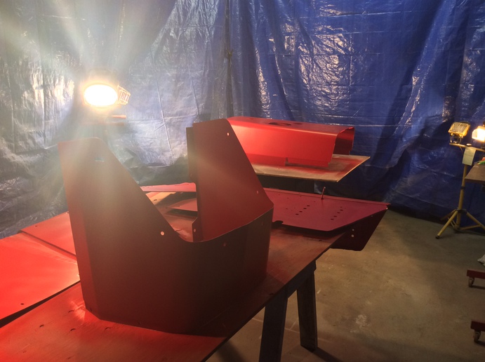

Thanks. I'd considered removing the front weights but in the end for me it fell into the 'I've got to stop somewhere and actually get this done' category. If I had more time I'd probably have ended up tearing it down a bit further. As it is I'm going to have to live with it. I'm one to two weeks out at the most I think to cut hay with this tractor. It's grown from a quick splash to a little more in depth.
I've been hard at it today and am just taking a break to let the red setup some before I clearcoat it. I upped my ventilation to three box fans for exhaust and one for a intake. It creates a negative pressure environment and has pretty much eliminated overspray and having to wait for overspray to clear. I'm really happy with how the red went on. Now if I can just get a couple coats of clear on with no runs. Lol.

Well that's that for now. I laid three coats of clear on the main outside of all the parts. Only could find one saggy little almost a run so far, so I think it went well. I'm going to leave them set up now for a number of days, then I'll flip em and try to hit the backsides with even a light coat of clear just to seal it up. I'll just have the reassembly of the panels as well as the seat and grills to deal with. Almost on schedule still I think.

Couldn't help myself I had heated my shop up pretty warm overnight so they seemed cured well enough to handle, so I flipped em around and finished the clear.

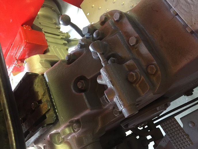

Well now it gets interesting lol.
I finished er up mostly today and got hooked up to the haybine to cut some hay. Well 15min in the front hydraulic pump went. I had modified the system and removes that extra three way valve under the footbed. When I filled up and ran it I made sure there was lots of oil and there seemed to be lots of flow back to the tank. No strange noises, no struggling and it functioned fine when I tested it the other day. Checked the level multiple times, but today was the first time it ran for very long. I must've had to much of a restriction. It stopped suddenly and there's no flow now.
So can anyone give me some advice as to where to plumb into my rear hydraulics on this tractor? I need to plumb my single spool valve in so just need a supply and return. Really don't want to screw up anymore hydraulics. But now I'm under the gun to mow hay.
Any help appreciated.
