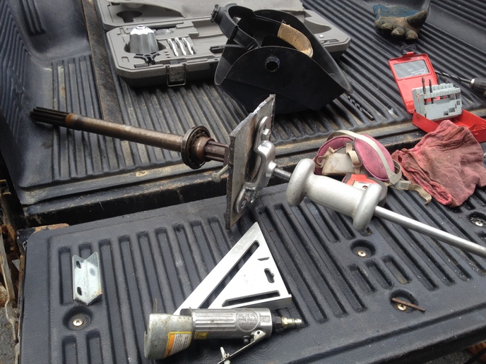

Me too. I think my seal was original from 1964, it didn't leak but I had to remove the hydraulic pump anyway and figured "while I'm in there" and I've got it all removed.
Here's the adapter I made up quick. It's ugly, all I had on hand was a piece of angle iron so I split it down the angle with my plasma cutter, pounded it flat, re-welded it into a plate and quickly cut holes in it. One day, maybe I'll make it pretty. It got the job done in about 5 seconds when I'd been prying and pulling on the PTO shaft for about 30 minutes and it didn't move.
Pro Tip- use a slide hammer! Smile

PostPosted: Thu Jun 14, 2018 4:56 am    Post subject: Re: MF 65 PTO seal replacement Reply to specific post Reply with quote
I'm old, just remembered :} While I had the shaft out, I replaced the bearing with a sealed type. I took the inside seal lip out so it would get oil. That way it has two seals. So if your shaft has wear at the seal contact point, the sealed bearing will solve the problem.
Sorry, I didn't record the bearing number.
