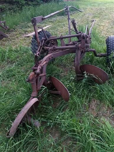

Hello everyone, looking for some help getting this plow I picked up last night functional. First of all it appears to lean to the right -what might cause this (besides the tires of course)? And what size tires should be on this? Right now they appear to be whatever was lying around.
Also with the plows crank turned all the way in, the plows still are pretty far down and drag when pulling. Is there an Adjustment for this?
Identification of model would help too- I'm thinking it's a plowmaster 100?
I appreciate any feedback/advice. Thanks!

I'm no expert but I think after you make your first pass the left tire would run in the furrow leveling it out.

I think its tripped . In other words trip
again pull forward and it will come up on
that side

This Oliver plow model was identified as a "Heavy Duty" plow. The lighter weight plow series were known as the "plowmaster"series.
As a 2-bottom plow, it would be identified as a 2-14 ; 2-16 plow.

The trip lever is the lever in the right if you were to look back from the tractor?

Yes, chances are if its been sitting for some time that drive hub will need to be taken apart and cleaned and make sure every thing spins and probly need new
springs. Its been a while since I did mine so I don't remember how it looks in there. But I was able to find off the shelf springs at local farm store that
worked.

Springs seem to be working, although they are pretty rusty. Never tore apart a hub like that. Any reference materials availabale online?

It's tripped. One of mine looks just like it except for the tail wheel, which is rubber.

I'm guessing this one used to have rubber on it too. Any problems running it without the rubber? Other solutions?

When I first got it, I had to lube up the lift with oil an free it up. Use the lever on the right to level the plow, an the crank for the depth, when it's in the ground. They plow nice.

That's how some came, I think I have two with front wheels rubber and rear is that steel disc wheel and another two that are spose to be full steel but the front
two where cut off and a rim welded on.

Any idea what size tires should go on it?

I think I took 6.00-16s off on mine but put 6.50-16s on because thats what I had.

Any idea what radial tire would fit in it? Have a few lying around
