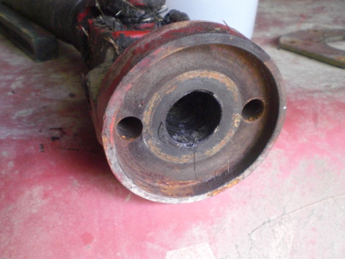

I have had a New Holland 273 small square baler for about 15 years with no major issues other than having to have one knotter replaced.
A couple of days ago the PTO shaft broke at the flywheel. There is about an inch to inch and a half sticking out of the universal joint yoke and the same depth hole inside where the flywheel slips onto the gearbox shaft.
My main question at this time is how do I remove the flywheel to get a better look at what happened. I assume the slip clutch needs to be removed from the flywheel, but then how is the flywheel attached to the shaft? Is there a bolt through the yoke that normally would need to be removed to pull the PTO shaft off the flywheel or gearbox shaft?
Have not had time to really study the parts yet as I borrowed a neighbor's baler for three days to finish the hay before the rain started again.
Any information would be greatly appreciated. Am hoping that the broken part can be welded back as if it is the gearbox shaft the two parts I would have to buy were listed on Messicks for $2,400 which is more than the baler is worth.
Thanks in advance for any help.

Post a pic and we can help. If it broke ahead of the slip clutch gear box should be fine. They usually break inside the slip clutch area.

Pto shaft is attached to the slip clutch. Slip clutch is attached to the flywheel. Once that is off there is a bolt holding the flywheel on. Use a cherry picker, chain hoist or a loader to pull flywheel if needed.

There is a slip clutch plate that bolts to the flywheel that has a pilot shaft roughly 1" diameter x 3" long. If you broke the PTO shaft and it
flopped around, it may have broken that shaft off. Plate is about 200.00. You may have lost the springs and pins that are part of the over-
running clutch. Measure your holes because there are two different diameters of those pins.
Remove the cone-shaped shroud over the clutch, then there are six springs compressed by 5/16" bolts that provide the resistance for the slip
clutch. Measure the compressed height of the springs before your loosen the bolts. There is a book spec for max. compressed length, I think it's
around 1.5". Remove the bolts and you'll be able to disassemble the clutch friction discs (2) and look at everything. If the frictions and/or
plates are glazed, consider scuffing them up with a Scotchbrite disc pad before re-assembly. When you re-assemble, pay close attention to the
center disc and notice it has a shoulder on each side. The friction discs MUST be on those shoulders so they are completely flat. I put just a
light bit of spring tension on the assembly and poked the discs with a flat screwdriver to center them. Failure to do so will result in a clutch
that does nothing but slip. Once the discs are engaged on the shoulder, tighten the bolts til the springs are the correct height.
Hope this helps.

After further investigation today I realized that the gearbox shaft and the shaft that the PTO connects to are two different parts.
First glance I thought the gearbox shaft went through the flywheel and the slip clutch and then the PTO connected to it. Today i realized that the PTO shaft connects to a shaft that is part of the base plate for the slip clutch so I will remove the slip clutch and proceed from there.

Got the Slip clutch taken off and apart this evening, think I need three different parts. Let me know what you think.
Feel I need the 1. clutch plate ( base that bolts to flywheel-broken shaft)--2. center clutch plate (one with curved grooves that rear end of PTO shaft fits in and 3. whatever goes in the tail end of the PTO shaft that makes the PTO shaft spin the baler. I assume that there are some sort of pins and springs that fit in the two holes on the end of the yoke.

Here is a photo that didn't upload the first time.
