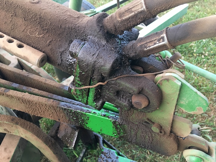

Hi. I bought a John Deere B2161R 21/2RC hydraulic cylinder. I put it on my John Deere A/44H plow. It had a slow leak between the "End cap" and the "Cylinder", so after a few weeks of use I took it apart and changed the gasket (B2163R), but it still leaked. Tonight I was out disking with the A and the KBA disc (which I've been using for a while) and in 3 hours it had leaked out enough oil so it wouldn't raise up. I'm wondering how I can stop the leak. Is there some special way to put it back together?

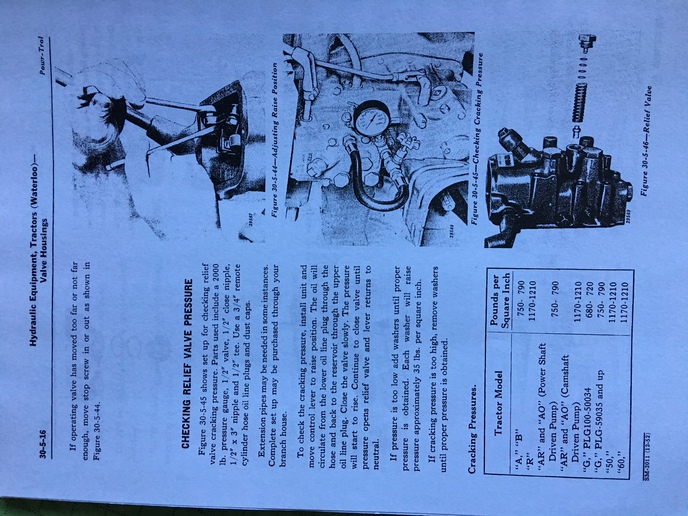

THANKS for the information! I've got another question. Is the page in this picture the correct information for checking the pressure? If it is where can I get the parts to check the pressure?

I cannot see the page in question. I just had a plain pressure guage with a remote hose adapter and pluged it in instead of the hose to the cylinder. You plug it in that you operate the valve for just a few swconds while reading the pressure. Any good farm supply should have those pressure guages. You only need a lower pressure guage of up to 1,500#, not the one that reads to 2,500# that is for like the old AC WD and other high pressure systems or newer tractors. On the A or a B it should be under a thousand pounds pressure unless you have the hydrolic pump mounted in back of mag-distributor then it is 1,250# pressure. And that is all that cylinder can handle.
