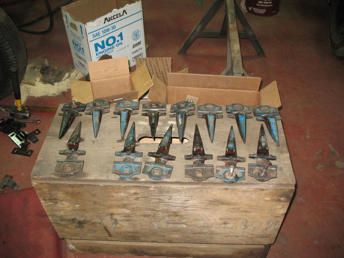

working on the ih-100 sickle mower today, took out the old knife, all the guards (a miss matched mess) saved the good ones and threw out the bent wore out and wrong guards. built a complete new knife last week. bought 15 new guards today. cleaned up the bar with the buffer and grinder, primed and ready for paint tomorrow. some pics of todays work.

sv. I was going to go with the new double guards and under cut sections, but when I got the mower in the shop I took a look at the guards and sections and this mower uses the same sections and guards as my case t-10 and I had enough on hand to build a new knife and just had to pick up 15 new guards to replace the bad ones so went with that. now it's just finish paint and assemble, and wait for some dry weather. just had another quick down pour about 10 minutes, and thunder storms and rain this afternoon Crying or Very sad

it's has a 7ft. cutter bar sv., worked on it again yesterday put the pto shaft with the new u joints in, went through the ledger plates only 3 left on it? and those were worn right down so another quick trip into case ih this morning for 7 new ledger plates. replaced 3 seized grease irks and greased, got to make adjustments to the pto shaft height (move it up) so the shaft will be running close to level on the m5.

replaced all the spacer plates not ledger plates Rolling Eyes

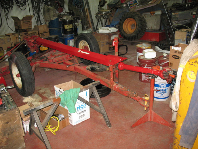

just about got the ih-100 ready for cutting today, had an idea last night on installing and dialing in the new knife bar assembly, I painted the new knife bar with primer (both sides) and then this morning installed the new guards, hold downs and spacer plates. slide the new knife in and put the pin in. rotated the pto shaft by hand and watched the sections and hold downs, checked the sections for rubbed off paint, raised those hold downs, checked spacer plates for alignment, resprayed primer on rubbed areas and rotated again, showed me any tight spots, 2 more rotations and it is dialed in turning nice and smooth with no binding Very Happy found both hydraulic lines rubbed through to the steel and weeping hyd. oil so pulled them both off to go in for replacement on mon. morning. here's some pics of todays work.

thanks sv., I had to pay a premium to get this mower and drive 250 miles each way but it was worth it as this mower had always been stored inside and looked after. still has a bit more work to do but i'm sure looking forward to mowing this heavy alfalfa field with it. will try and get some pics and video of it mowing.
