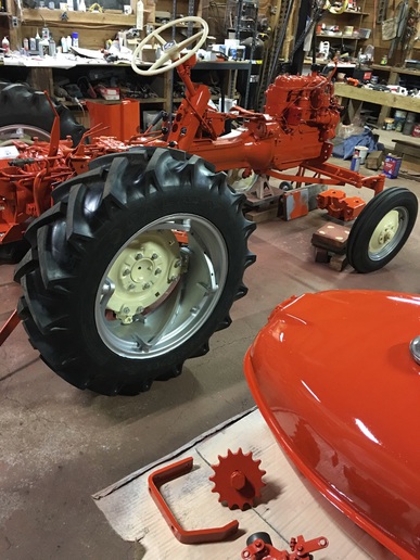

I've been restoring (cosmetically) Kim's D10 SIII. Just got the wheels back on today which is always my milestone. I'm not doing near as much with this one just because it was in pretty good mechanical shape, just the steering gear, rewiring, tires, oil lines and filter mount, manifold, carb rebuild, some hydraulics, fluids, carb rebuild, steering wheel refurb, electronic ignition and new gauges (and of course all the small stuff like hoses, clamps, knobs, and many fasteners). Most of the work has been cleaning and painting, but it's on the downhill slide now. I have a journal running on it, but I thought I'd post my milestone since it's rolling again. Hopefully by the end of July, I'll post the after photos so Kim can get on with her bush hogging and scratch it all up.

The series three had a lot of improvements that make it a nice little tractor, range transmission and sufficient front weight make it a more capable little machine. This is a 64. You can't see it in the photo, but it has a skookum front weight that replaced the sheet steel radiator support, and then another heavy weight that bolts outboard of the grill/radiator shroud (that's what the oblong holes in the shroud are for). My 61 D12 tends to be very light in the front and they solved that with the Series III. The rear deck area is different on these too, has a more finished appearance using the full sized fenders. The Series III uses an identical fender to the D14 only with a section cut out at the rear bottom to make room for the cross beam of the factory 3 point.
I found another one available, but have spent my tractor budget for this year, and have too many others awaiting restoration.

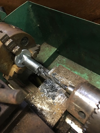

I tried like heck to find those light bolts in a larger size, because the base of her light shells had expanded over the years. So I had to dust off the lathe (after 20 years inactivity). No precision here, just a drill bit, but it worked fine:

That's what's going to happen, Kim picked up another bush hog just for it. It should be better than my D14 for pto work. She didn't even really want it restored, but fixing the first few electrical problems proved it had to have the rust eliminated. It also had other mechanical issues that required a lot of disassembly, so it made no sense to clean and paint parts of it without doing the whole thing, would have looked silly. Now that I've had it all torn down, it really needed it. There was clay an inch thick in spots on it, couldn't have worked on it the way it was. But it's totally a working tractor.
